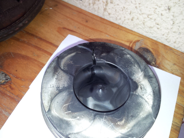

I would have someone look at this. Pinging may be caused by a leaky injector and it may be caused by pump timing amongst other things.Marlowe wrote:This and other recent posts have given me some concerns. My SWB 2006 DiD has 147 000 (genuine)km's.On a trip over Christmas near Vryheid, I experienced a pinging noise from the engine on several long climbs when the car was in 5th gear...
The recent posts about similar problems being possibly caused by injectors rang alarm bells but I thought that at my fairly low milage this should not be a problem. ... Should I be getting the injectors replaced? Is there any other possible cause for the pinging?
