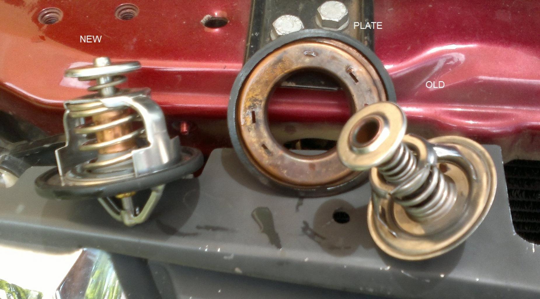

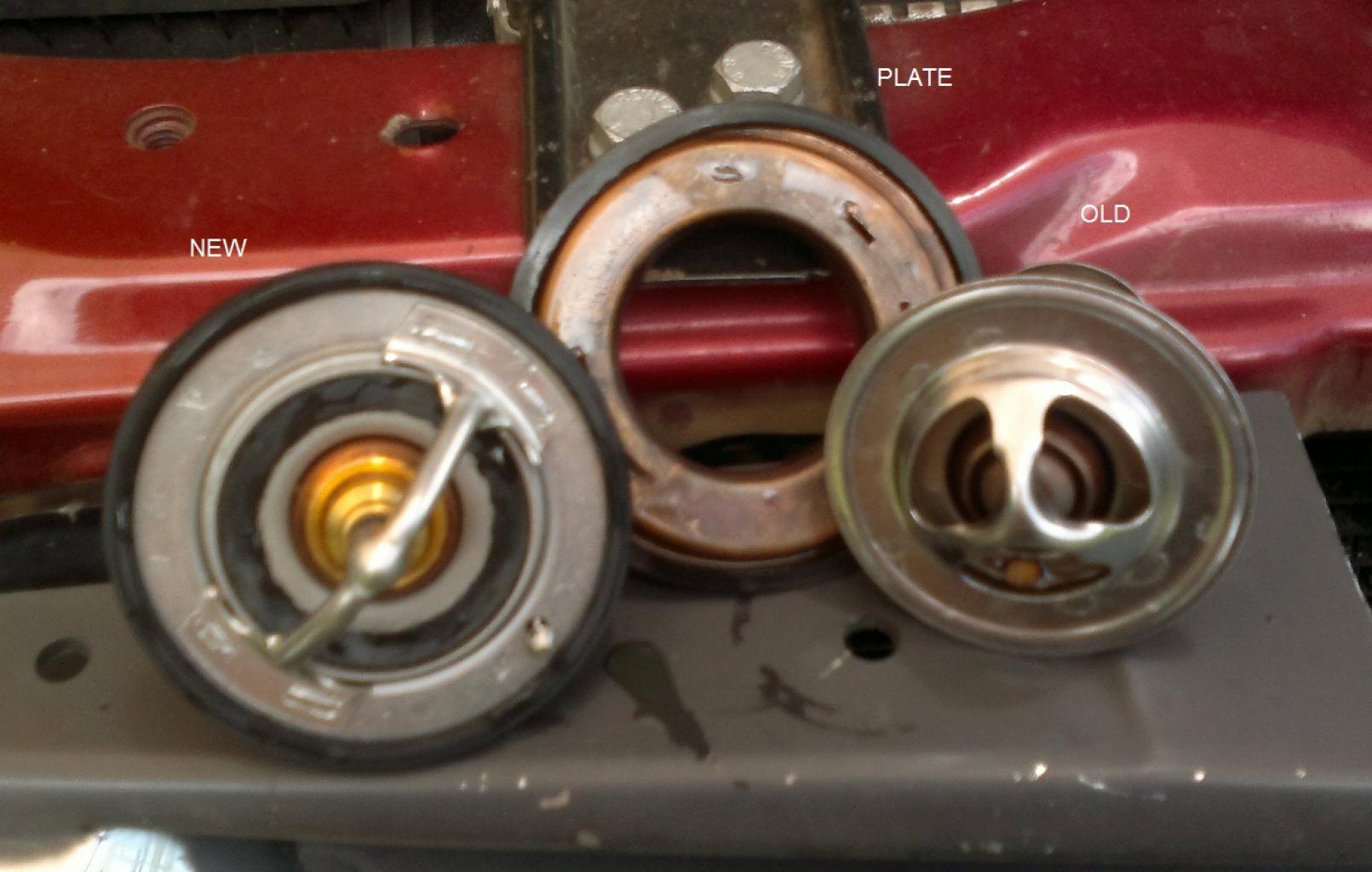

Hi all,
In the post above I mentioned that I removed and tested the thermostat but also that I bought a new one from the Dealers just in case.
Well - when I took it out an hour ago I noticed that the new one was far bigger than the old one. Fearing that they gave me the wrong one and it would not fit I noticed that the old one had a round spacer plate around it to make it fit in the whole.
Must have been a pirate part conversion.
I had no idea that the spacer was not standard until I could compare it wit the new one.
See pics attached.
I have high hopes that this would improve the consumption since the temp afterwards behaved far more normal.
I'll post my findings after the next 2 fills.
Thanks once again for everyone's input.
