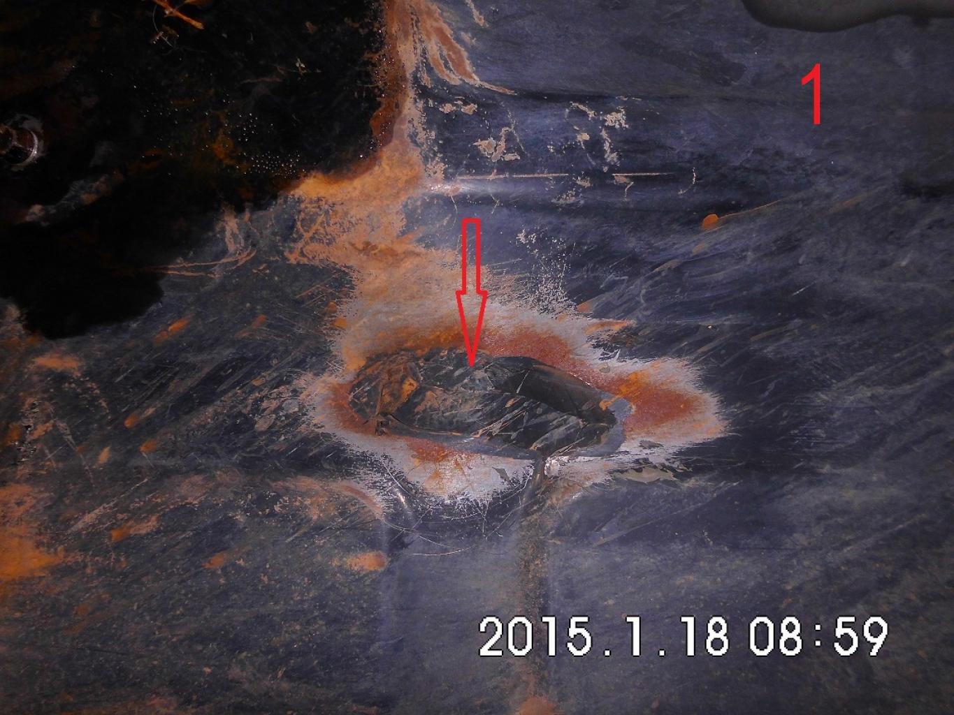

After many off road camping trips over the past 15 years, the diesel tank on my MK1 developed a 50 mm long crack on the bottom. A fair bit of deformation had taken place.
Knowing more off roading will at least flex any repair, I removed the tank, washed it and had the crack gas welded, inside and outside.
The repair is sound after a recent 8400 km Namibia trip, I do think the repair is as sound as the remaining tank bottom.

Changed my cracked tank at last.
Here's a proof of my incredible suggestion to use silicone (!) to seal that classic pajero tank crack. It must be windscreen silicone.
The silicone lasted for 3 years, & still looks ok!
