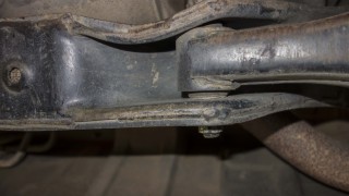

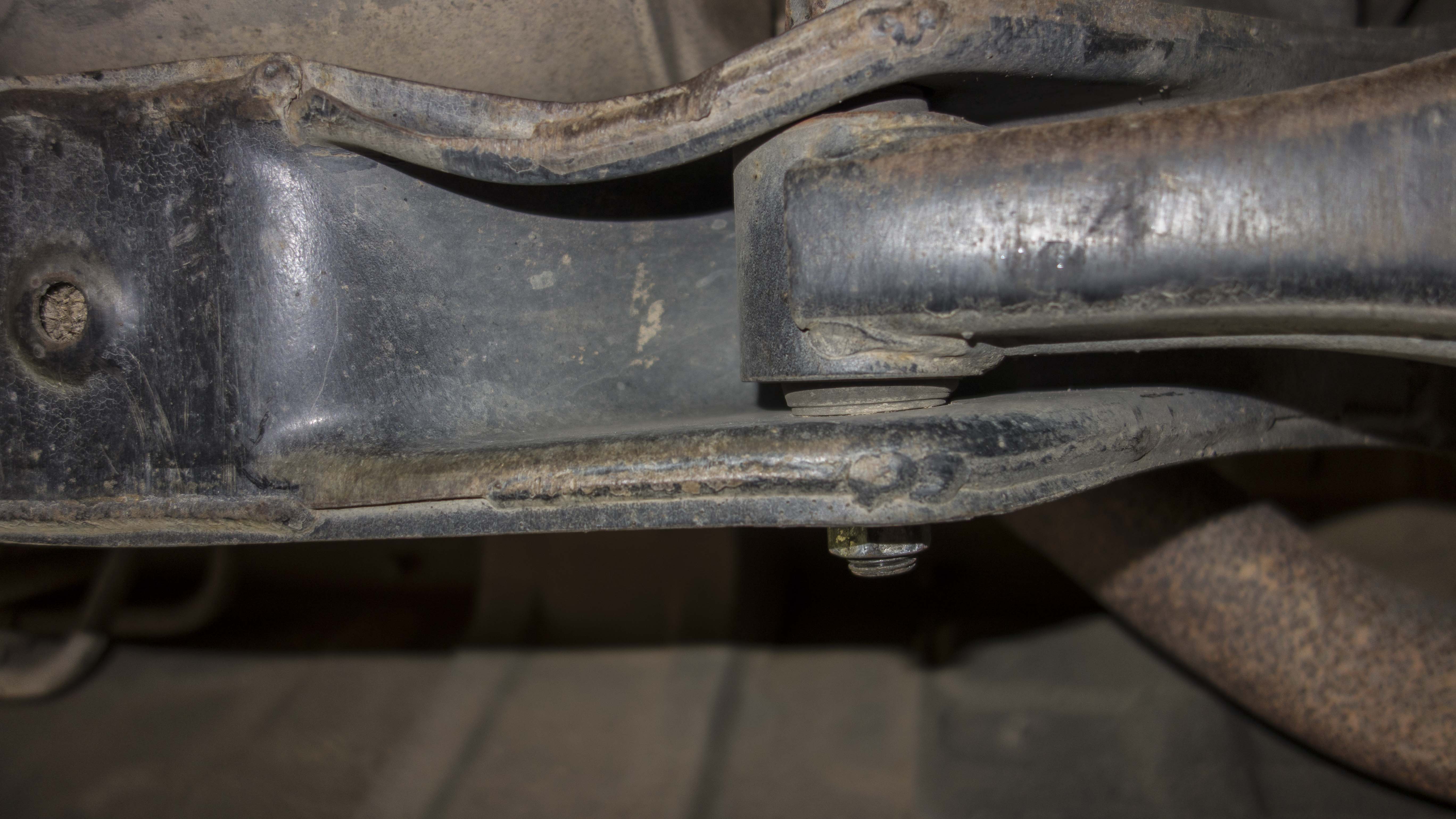

I've found one area where a resonance might be coming through to the chassis (left rear) - obviously previous owner hit a rock somewhere:![Image]()
Will get it repaired some time when I can find someone who can bend the bracket back (tried a 10 lb hammer but it wouldn't budge).
