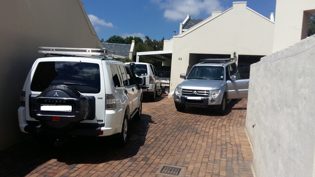

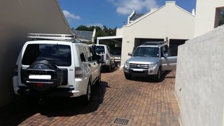

Three more Pajero's with solid dashboards and whatnot, it always feels good to help a fellow Gen4 owner make their driving experience a little better.

Myself and a mate, Piet, had our dashes fixed by Kurt this morning.
Kurt also sorted out a very poor aftermarket radio fitment on mine which the previous owner had done!
We can both report a noticeable difference on the bumpy roads around the plots in our area! In fact mine is DEAD quiet! :D
We are heading to the Transkei coast during December and will report back on the findings after the trip!
Thanks Kurt!

Very poor fitment is an understatement. I used up my last 3 white clips and one from a piece of trim on my car. Then we had to also use 4 of the clips from your car. That's 8 missing slips and I glued 3 or 4 of the broken ones we found on the facia. It is unbelievable how poorly these fitment centres do the installs, every single car I have seen with either a new radio or parrot system requires new clips. Glad I could help you out!
