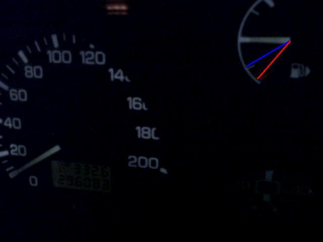

My gauge is now at the blue line after 520km (includes a bit of off roading), where it used to be at the red line after 520km.
Time will tell with the next fill up what difference it has made.
