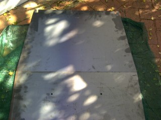

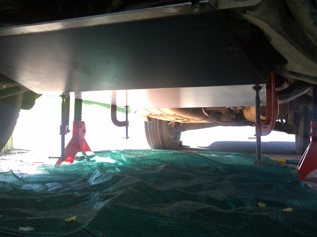

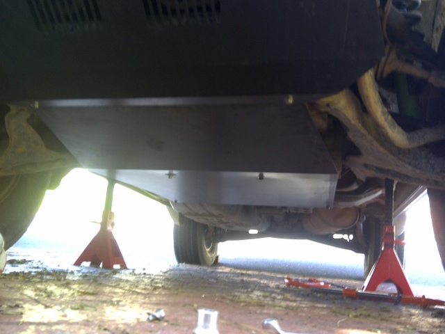

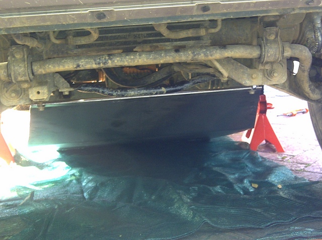

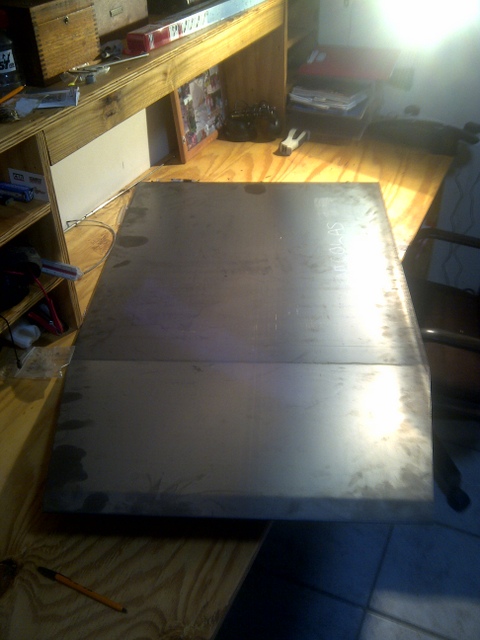

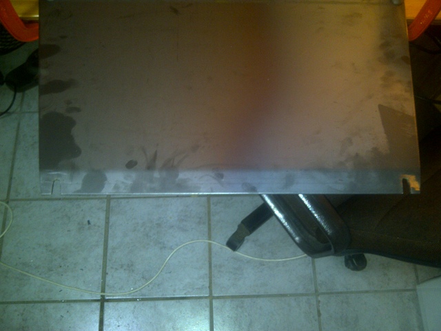

HI Guys, Pics as promised.
I decided to have the plate bent up for me, as 4mm steel is too stiff to do at home, it cost me R 465.00 for the metal sheet of 1300 x 750 x 4mm, and R75.00 to have it bent and sides trimmed.
All in all it cost me a sunday morning, a couple of choice swear words,(hope the neighbors didnt mind...
) and 4 high tesile allen head bolts which I had in stock.
First I drilled two 10mm holes and slotted them with a grinder.

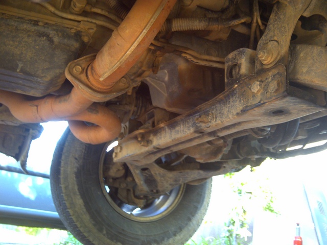

Then I looked for attachment points on the front cross member, fould two mounting points from the old carbon fibre splash plate.

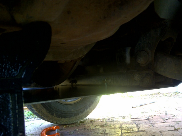

I then clamped the plate to the chassis to measure the holes for the front cross member, it bloody heavy to pick up under the chassis at approx 20kg...
Drilled holes...

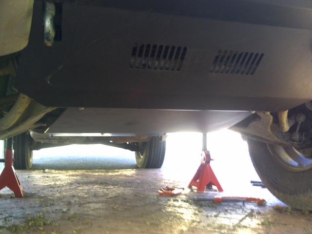

Fitted the belly and bash plate, I got the bash plate from Zoobie, but have taken the measurements to have another one made up that is thicker, 3mm steel front runner isn't up to the task IMHO.
I know the bolts protrude out unde rthe bash plate, even more as they are allen bolts(have a higher profile). They were the only high tensile bolts I had at 12.9 on the head. I will shop around for a normal bolt profile, but will just carry spares around for now if they shear off, or until I can make a better plan.

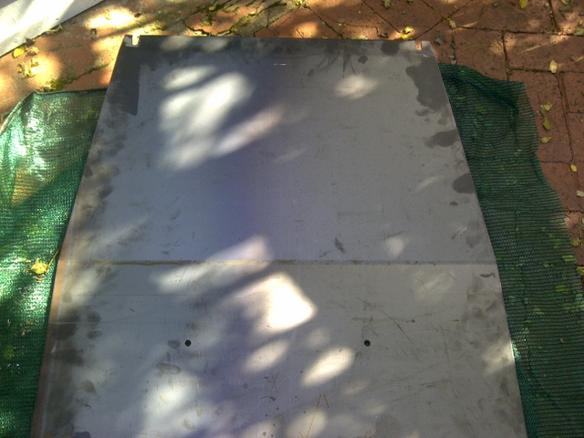

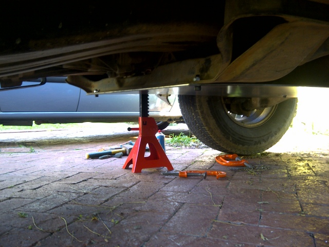

Better view of the front and rear cross member attachement points.
