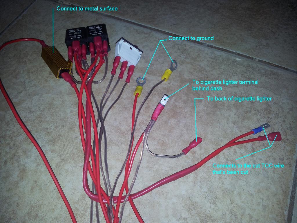

With my third relay clicking at the PWM frequency I could get an idea of what the standard lock up does on my last test drive. It rarely locks up in third or lower but locks happily at med to high throttle in fourth. At the slightest prod of the loud pedal it unlocks in fifth.
If need be I can at a small extra cost add a LED to the loom that illuminates with the factory ecu lock up (ie. when the override switch is off) or just give instructions on where to get the signal to wire in your own.

The gen3 box is very robust and can take a lot but I wouldn't do it to be on the safe side. I did it by accident once and the car stalled with a jerk. It didn't feel good.
Best is to make it clear to the other drivers on how to use it or to leave it well alone.
It will feed from the cigarette lighter 12v so if you want to disable it from funny hands it will be easy to just pull the cigarette lighters fuse.

First kits are made. I just have to get different switches. The bloke behind the counter gave me 240v switches instead of 12v switches.
I have received payment of 2 kits already and they will be sent out before the end of the week.
This is the basic install instructions and the look of the kit.
The price has been fixed at R1150 which includes the kit, instructions and a few small items to complete the install.
All you will need is basic tools (screwdriver etc.) and a crimping tool - a pair of pliers may work as well.
