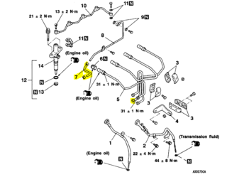

I have had a lumpy rev at about 1500 RPM with a bit of engine vibration, and I also have had a persistent slight diesel smell about my van for a good while now. Got under my van and found a slight dampness around the back of the injector pump where the injector pipes connect. Seems one of the union nuts on an injector pipe was not snugged up correctly when they re-installed my pump - (see yellow highlighted pipe).
Injector pump pipes
Injector pump pipes
Unfortunately the only way to snug up the injector pipe in question without removing all 4 of them, was to access it from underneath the vehicle by removing the starter motor. I tightened it up with 19mm spanner, some double jointed dexterity is needed, and all was good.
I also found the the short rubber leak off hose (No. 7) was rock hard and had perished and was also leaking a small amount of fuel. This is the diesel injector leak off hose that returns the un-injected fuel back to the injector pump to be sent back to the fuel tank to be re-cycled. It is used for cooling the injectors.
I had to remove the whole steel pipe from the banjo fitting at no. 9 to fit a new hose due to access issues. Seems the fuel is VERY hot coming from the injectors and had 'cooked" the cheaper hose used by CL diesel, allowing fuel past the spring clamp as it could not seal anymore; as it was not pliable. I replaced it with a better quality hose supplied by them and will see how it holds up.
End result:
My EGT's have come down at least by about 50-80 deg C, seems the one cylinder was not performing as it should causing the other 3 to work MUCH harder thus increasing the over-all EGT's. On a usual hill where I used to hit about 730 Deg when flooring it, I now max out at 650-670 deg C. Still a bit high but in the 'safe(er)' zone now. Engine no longer has the lumpy idle and seems to pull alot better.
Must say I am Happy Chappy!
