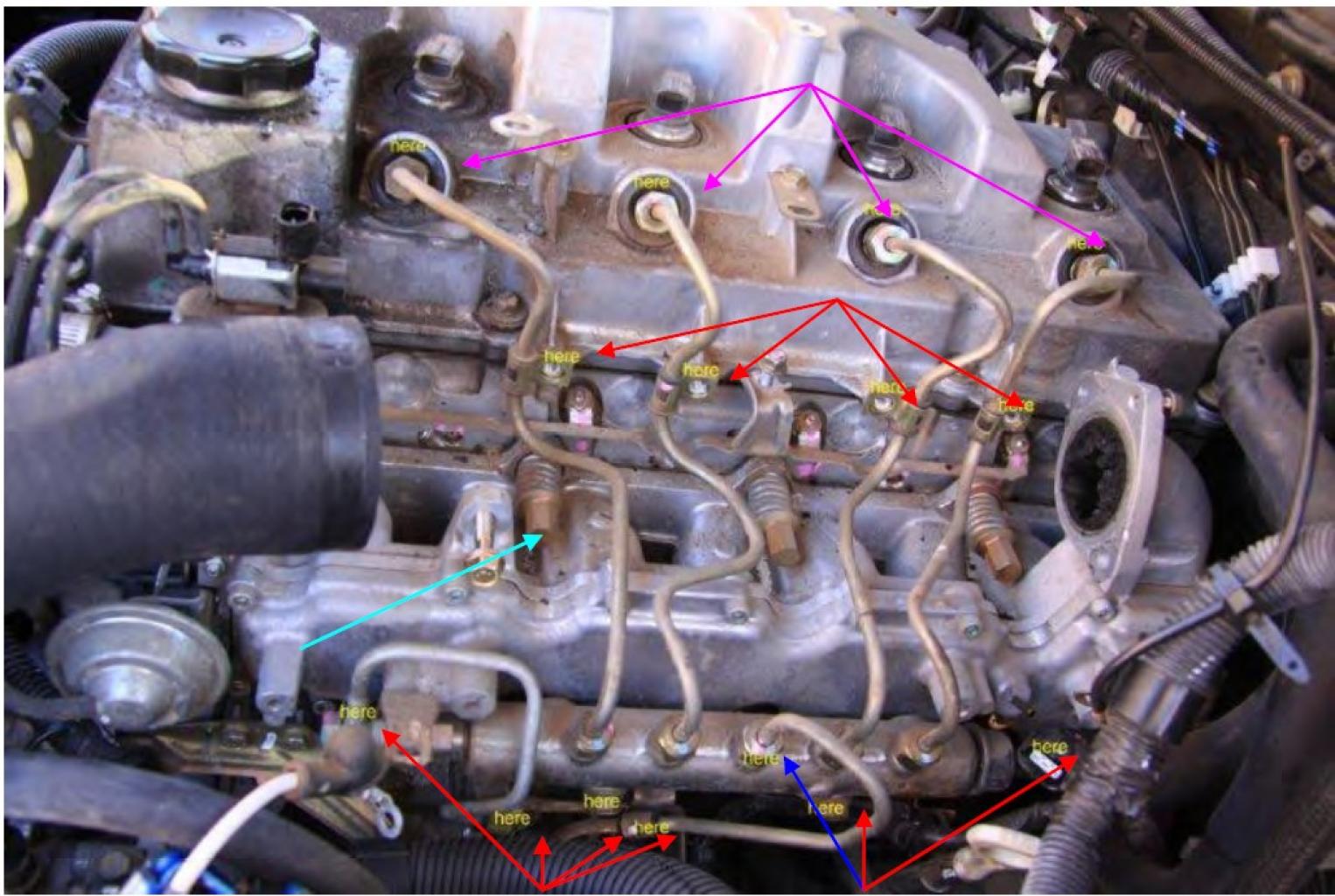

So I assume you removed the upper intake manifold (with the EGR attached). And looking into the lower half?Did you do a pull blanking plate? Don't you get any error codes?
Is this how far you went?
Most guys in Australia say hat their EGR, and upper and lower intake manifolds are very blocked up with soot, and cleaning makes a big performance difference. See the soot build up in the above photo.
In a way, I'm hoping that the manifold is clean, but another part of me hopes it is very blocked up and that cleaning it improves performance :)

Yes Greg that is how far I went it was not necessary to go further as my main interest was setting the valve clearance. Yes I just made up blanking plates on the flanges on both sides of the egr cooler. I saw that cooler was now water cooled (Gen 3 not) and decided an additional blanking plate would just make me happier. My blanking plates have no holes and I have no fault codes.
I read up about overseas guys getting fault codes and having to drill holes in the blanking plates. As mentioned by Cats and I we believe that we in SA have new models with older technology and I believe as a result of this, is maybe why we do not get the fault codes (let's see what others have to say). We also do not have the Variable vein turbo's and DPf'S that they have fitted to overseas 2009 models. While on this subject - watch this space!!!!!
