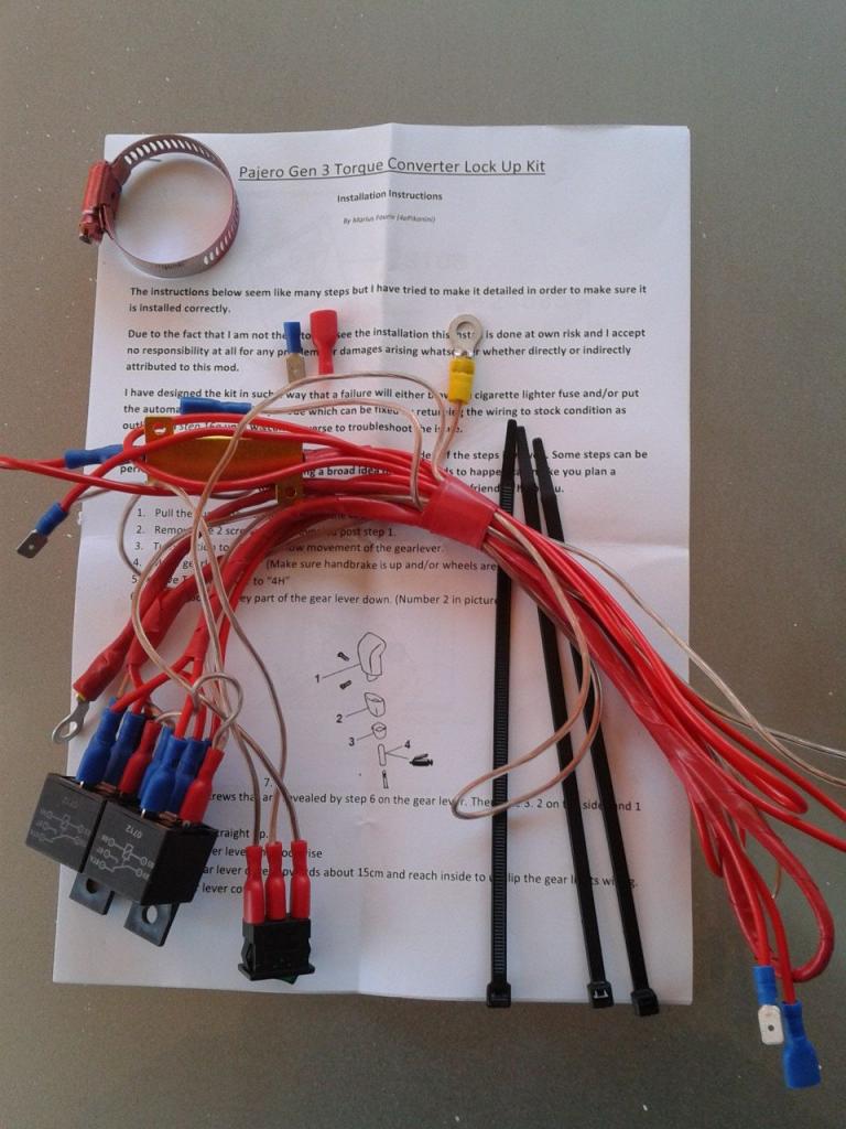

I have just received my lock-up kit from Marius now and cannot wait to work through the instructions - six pages, nogal - and to start fitting it tomorrow or this weekend.
I am most impressed with the quality and completeness of the kit, including cable ties, connectors and a clamp, and wish to thank him on the forum for such excellent work and service. I am sure that he will be on call when and if I strike a problem. Thanks, Marius. You are an asset to the club.
And for others to drool, I am posting a picture....
Thanks for the compliment Gert. You are the first guinea pig so to speak, other than myself so give me a call if you have any hassles. I'm sure you'll be fine though.
I spend hours and hours going through the intricacies of the wiring and the instructions to try and make it as complete as possible and to make sure it's right.

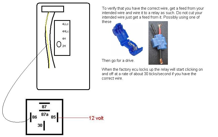

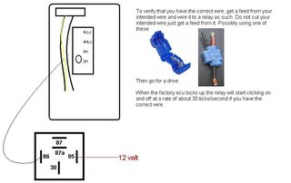

You need to do some research to check if your wiring is the same as the diesel which I suspect it is.JohnDG wrote:Hi Marius
I'm definitely interested in the Lock up kit for my Gen 3 3.8 V6.
Regards,
JohnDG
removing the center console you will find a wiring arnass that comes from a big white connector and runs past the transfer lever to the back.
You need to find the yellow wire with a red trace and then do the following test to see if it is the correct wire.
If it is I can sell you a kit
