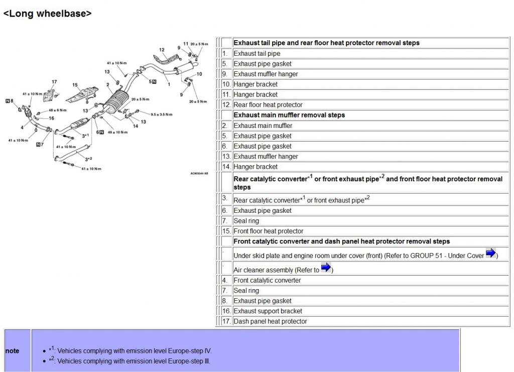

My Pajero only has one CAT - just after the turbo.
There seems to be 2 versions, based on the emission regulations.
Euro Spec 3 - One Cat just after turbo.
Euro Spec 4 - Two Cats (one after exhaust, and one under car).
See the diagram - Part number 3 has two version - one with CAT, one straight pipe.
