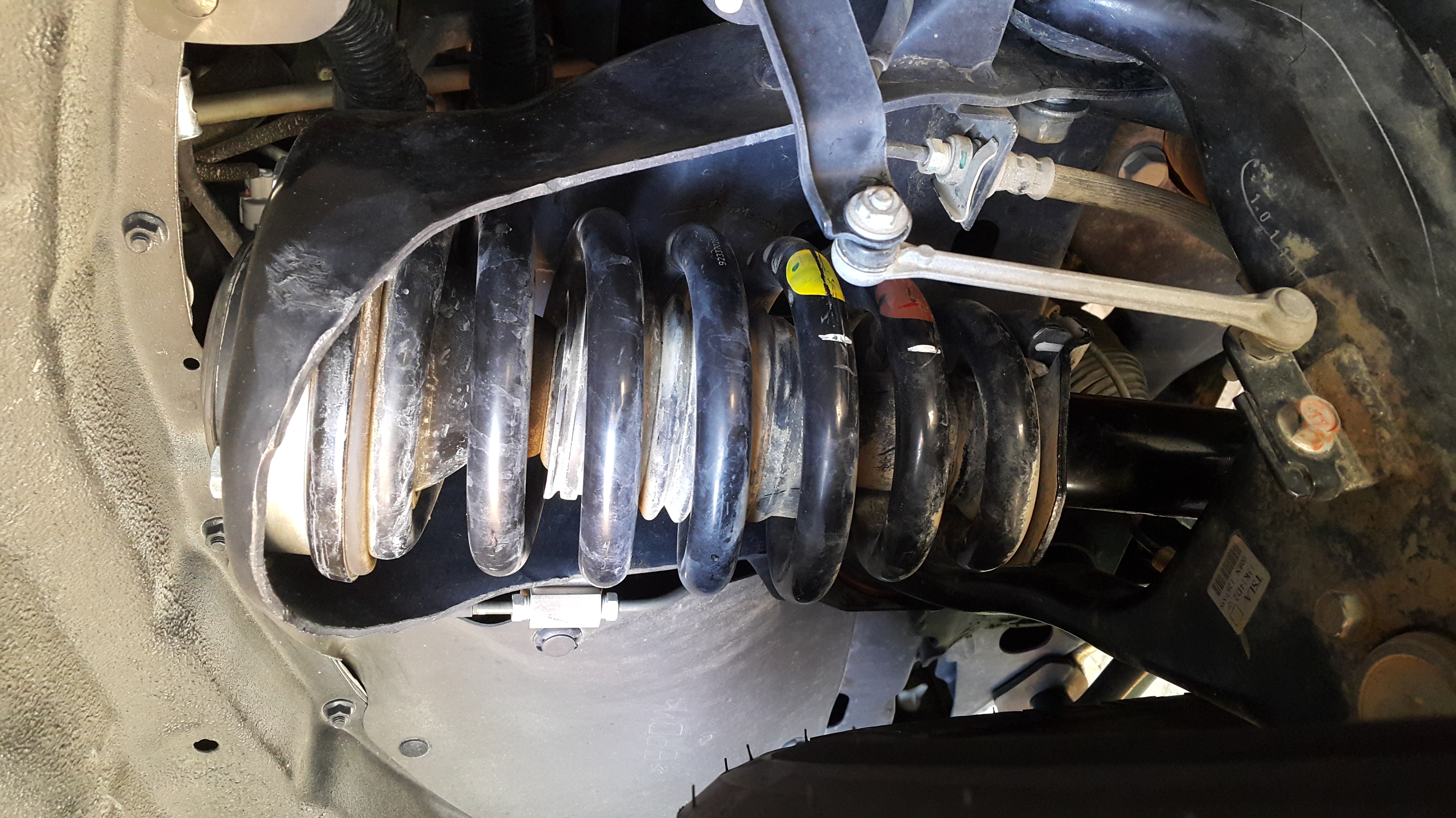

Photo: Placement of the spacer on top of the strut.DID Man wrote:Hi Leon,

Thanks for the photo Leon, I hope the spacer mod works well on the front strut.

I also popped into the Mitsu agents and crawled in under the Sport and I think the scope for mods are very restricted because of the mounting points of the back shocks being so close to the anti roll/sway bar or whatever it is called, they barely miss each other. There is also not a lot of room around the front strut to allow any radical change from standard.
Your mod may be the way to go for now Leon, let us know how it performed on the trip back home.

Dear forum members, I gave poor advise and need to rectify this:Namboer wrote:Talk to Shaun at Bongwe 4x4 Centre Westrand - got mine there R2k cheaper than quote from LAS.Gert Kruger wrote:Talking about a nudge bar. Where is the cheapest place to get one for my PS, gauteng area?
PLEASE do not use my post above as a good reference, or otherwise, if you EVER use this outfit to work on any suspension, please make sure that they tighten the bolts.
Yesterday at noon I almost lost my PS and the lives of my wife and I, some 70 km before Kang in Botswana, when the left front swing arm bolts fell out after Bongwe fitted strut spacers. The bolts were only tightened by hand, and never saw a spanner or torque wrench !!
Mitsu in Winhoek will now repair the damage - which is extensive.
