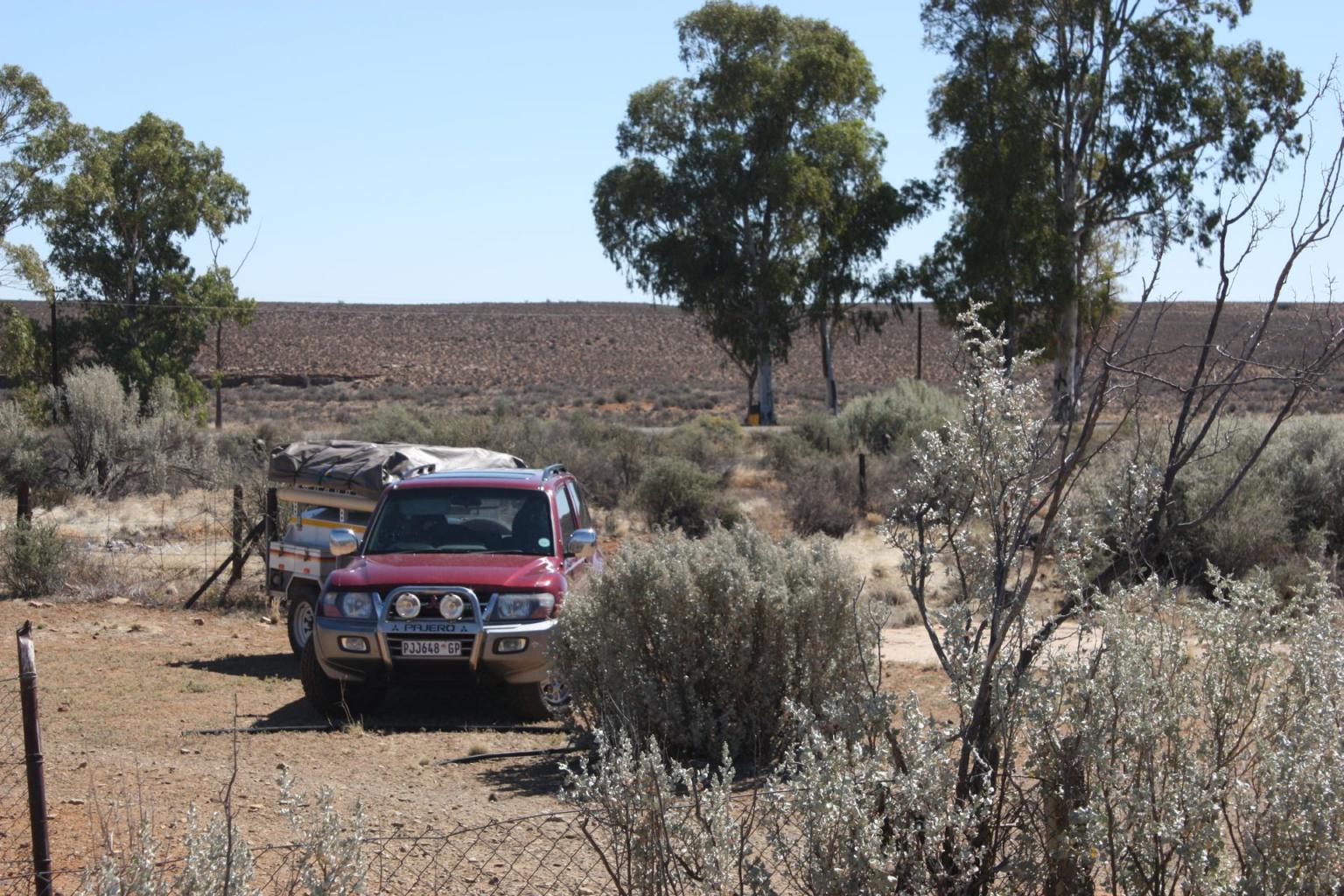

Suppose its time for an update on the fitted kock up kit.
I have just returned from Namaqualand and I have done just over 3600 kms.
Of course, most of the kms were done with the trailer in tow and the consumption in between fill-ups varied.
Bottom line is, the diesel consumption was an average of 1 kilometer per liter better than that without the lock-up kit. The consumption solo on the open road also bettered with 1 Kilometer. O, I must mention, I traveled long distances with the cruise control on.
All in all, I think it is a worthwhile conversion, especially when you can lock up below 120 km/h when towing and the fact that there is no slippage and heat generation. What I did was, when there is a slight uphill, I switched the lock off, which resulted in a slip in the transmission which equaled the hooking up of a lower gear.
It works for me.

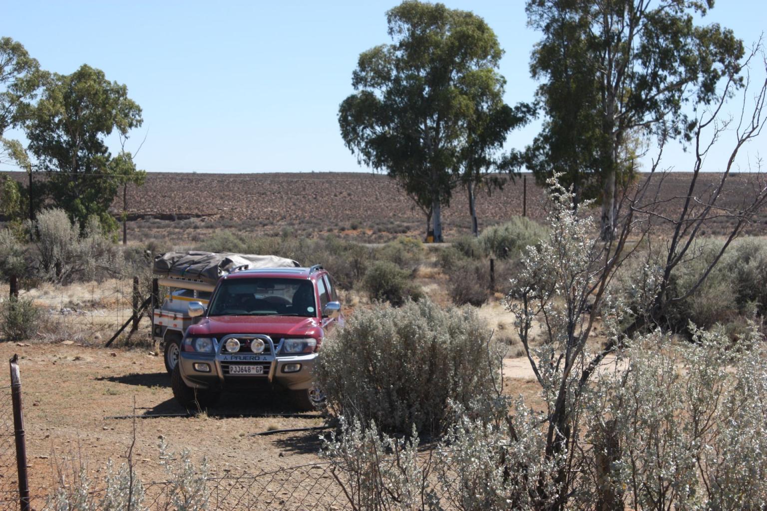

Forgot to mention:
The overall consumption was 8.5 km/l where in the past with the trailer it was 7.6. Solo I constantly get just over 10 km/l @ 120 km/h
