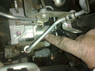

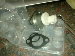

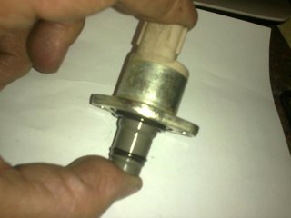

So we are going camping this weekend. I did not want to tow with the poor vehicle performance as is so I replaced the suspect Suction Control Valve in the hope that it will rectify things. At R4450.00 from the agents it was going to be an expensive shot in the dark. I was able to source the same SCV from an alternative supplier at R2200.00 !!! I needed the pump number (eg 1460A037) to match the correct SCV from the supplier. The agents gave me a pump number according to my VIN 1460A044. Once you can actually see the valve you can read the pump number off the sticker there. Mine actually turned out to be 1460A022!
Packaged with gasket and O ring
Front Lower L/h side of engine

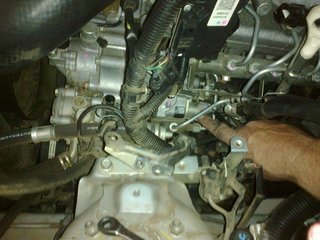

This is not an easy job. Suggest you use a fender cover. I have OME suspension which being higher made it that much more difficult to reach. You need to remove the battery, battery tray, unclip the pipes and wiring harness obscuring the valve, now you can see the SCV.
The sticker with pump number is next the valve.

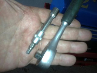

You need a small ratchet and a 5mm allen key socket to get the cap screws loose (difficult if you have big hands like mine!)
You need a small ratchet extension and 5 mm allen key socket
Clean the area before removal. It is easier to unplug the electric plug once the valve is removed. Fit the new gasket and O ring and fit the new valve. While you are about it fit a new diesel fuel filter. Return all pipes, wiring and battery to original positions.The vehicles Engine Computer Unit needs to be commanded to relearn the new SCV.
