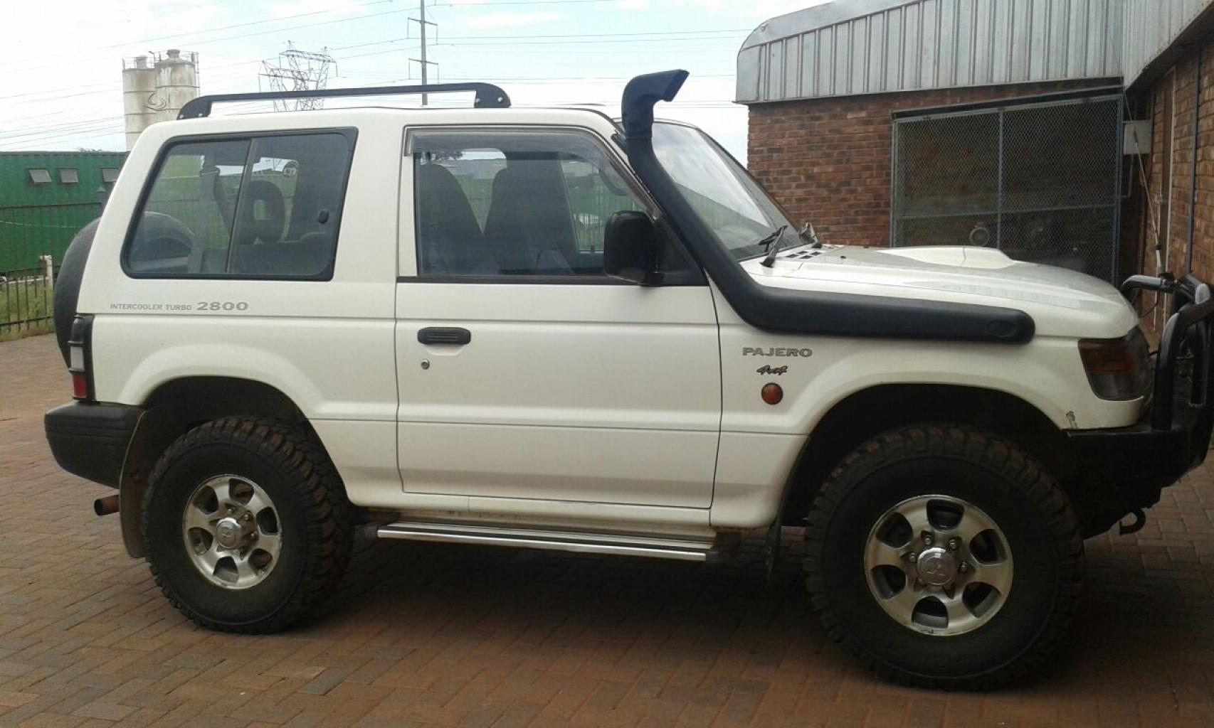

I added a snorkel and put 4 new mud terrain tyres on then it was time for a major service at 321 000km. An oil leak was also sorted out.

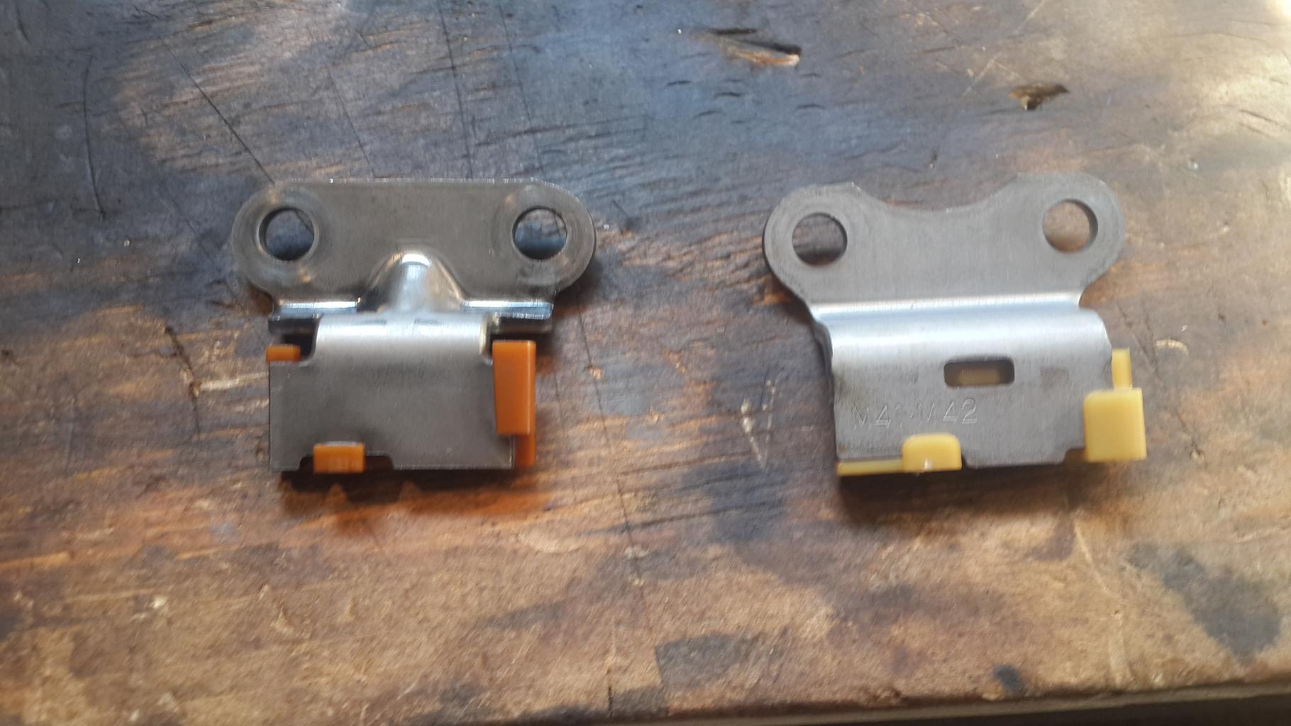

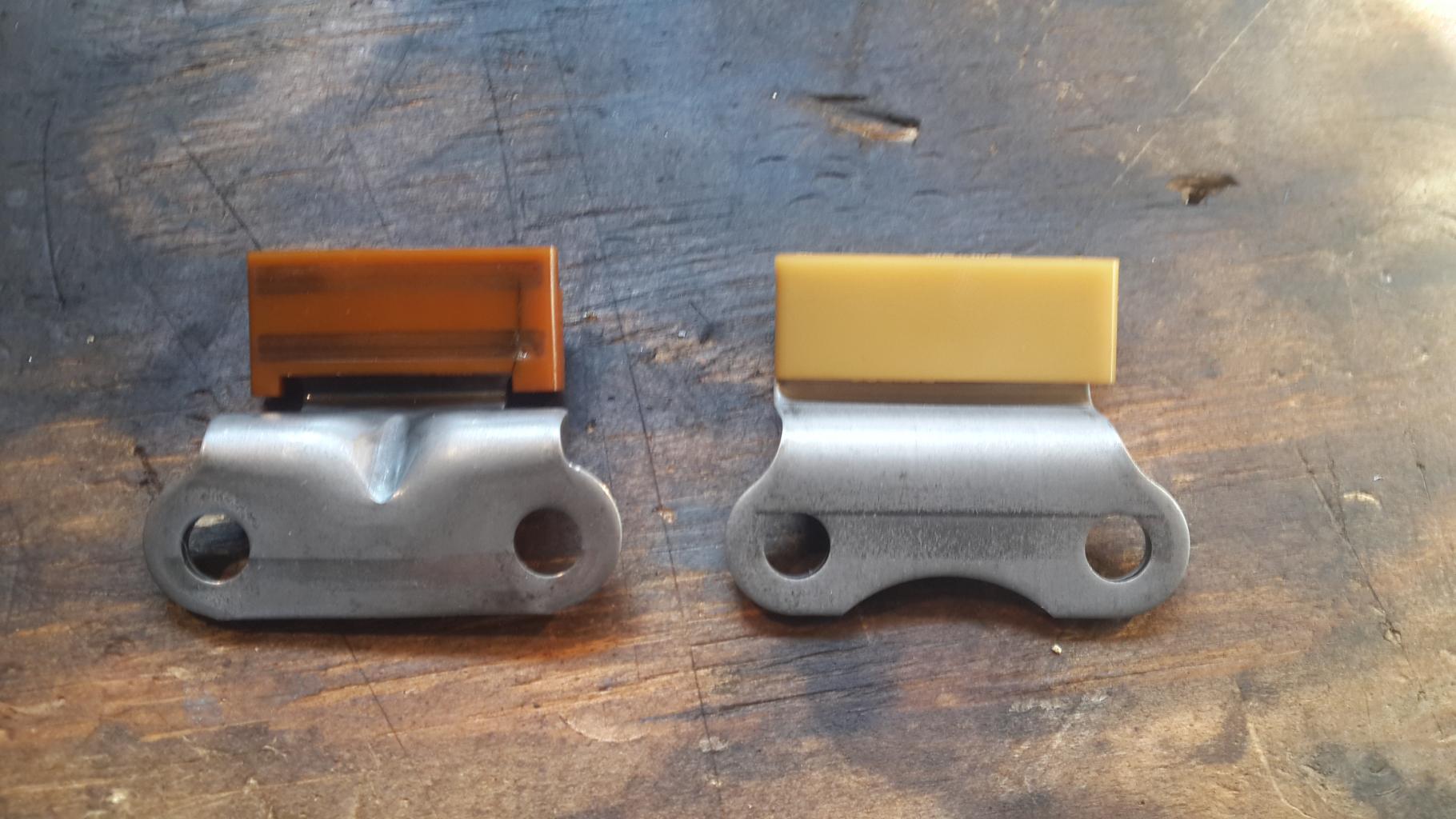

Shew, it has been a busy week.
1. De-catted Pajero
2. Cleaned intake manifold up.
3. Changed out upper timing chain guide to new upgraded one, original was cracked.
4. Had injectors checked for spray pattern and pop pressure, all good.
5. Broke 1 Banjo and 2 Injector bolts off under rocker cover due to crappy torque wrench, had to extract and repair.
6. Bought 2x 4lt of DiaQueen ATF to do tranny oil change some time in the week.
1. De-catted Pajero

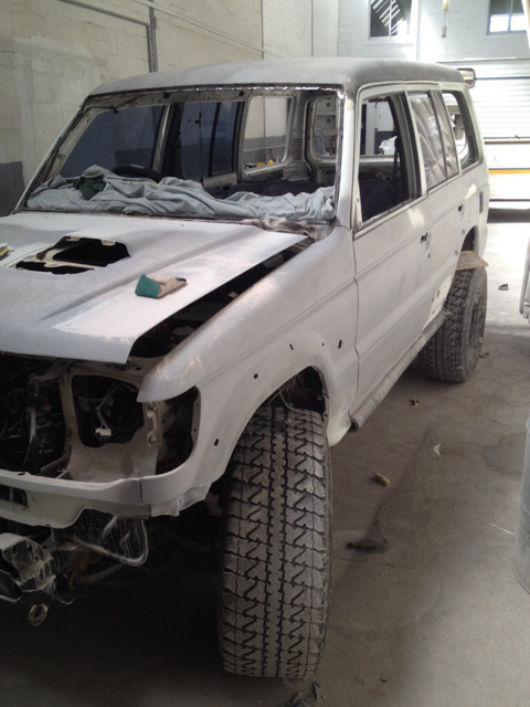

Giving my Gen2 a new lease of life by getting some required bodywork and a complete sprayjob done... Progress is steadily taking shape and I can't wait to have a shiny new car in a few weeks
