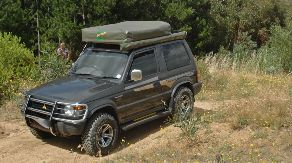

Work done since purchased : clutch kit, g/box recon, new c/m/cyl & recon c/s/cyl, recond starter, new cambelts & tensioners + front seals, new h/d radiator + hoses/therm, recon idler arm, new upper wishbones + b/j's + lower b/j's, renewed rear brake shoes, brakes cyl wshrs + rear whl brgs,, recond b/m/cyl, bash plates, rear shocks renewed, new rims & Cooper STT 31x10.5R15 tyres, drawer system, fridge, NL battery system, roofrack & RTT, volt/oil press/water temp gauges, LED retrofit, anti-smash & grab tinting, hands free kit, battery, v-belts, injectors, dyno tuned, diesel pump calibrated, AND COUNTING
Things to do : Ironman suspension upgrade, off-road front bumper with s/h winch, fitting wading-depth breather pipes to g/box, transfer box & diffs
