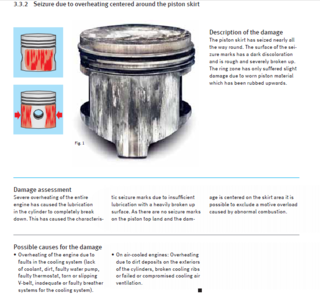

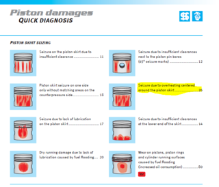

Ok here is more reading on the damage I had on my pistons.
Here is the reference page with typical damage, I ruled out all others, the only one it matched was the piston skirt damage due to overheating.
Piston Damage
Piston Damage
Reference page
Piston Damage 2
Piston Damage 2
Symptoms and possible causes.
piston_damage.pdf
(3.08 MiB) Downloaded 253 times
Document.

Looking back, I recon I did the initial piston damage at about 150km into the first running in process, when I took the car to work the first time. I was just picking up speed on the highway when she lost power and stalled - CEL came on. I coasted to the side of the highway and had a look at the engine bay, couldn't see anything wrong (oil, water leaks, etc) or any funny smells. I cautiously attempted a re-start and she caught first swing - must have been an airlock in the fuel system - or so I thought...
Ever since then I heard a light tapping noise at startup - similar to a noisy lifter on a V6 until the oil pressure builds up. At first it was only at startup and went away, then got progressively worse until it was doing it the whole time while driving, also with occasional bouts of of blue smoke until warmed up. When that happened I decided to pull the engine tear down and see what was wrong - I though small-ends bearing - but the blue smoke was puzzling me. In the end, it turned out to be piston slap due to the over-heat and resultant collapse of the pistons.
Suspected cause:
Steam pocket or airlock/hotspot due to lack of coolant. Possible coolant bleeding issue?
