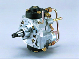

I found some images of the pressure pump on the internet. This is the pump as you see it from above. The 6mm allen key plug is on the other side.
densocr pump1.jpg (84.46 KiB) Viewed 2894 times
This side can only be seen from underneath.
denso cr pump 3a.jpg (12.14 KiB) Viewed 2894 times
It is the bigger plug that takes a 6mm allen key which has to be cut shorter to fit between the engine block and the pump.

Cats, while I was researching I found an exploded view diagram of the Denso pump which showed a small filter with an allen key plug situated next to a delivery valve (I cannot find it on the net again!). The older type Common Rail pumps show a filter at the pump inlet banjo bolt but they are different. Compare the photo with your pump. My inlet pipe goes straight into the pump with no banjo bolt. I then phoned and was told that there was only one filter in stock and that was in Cape Town (ie - they do not sell many) so I was pretty sure that this was a small reusable metal filter ("siffie") which it is (about 4mm x 10mm). So yes we just cleaned a seemingly clean filter and put it back. It is not an easy job and the 6mm allen key plug was extremely tight and inaccessable. The engine mounting is also in the way. We cut the short end of a 6mm allen key shorter to get it to fit in and found it so tight that we cut a small piece of pipe to put on the allen key and ended up just bending the key. The answer would be an allen key socket but there is no room for it. We ended up damaging the allen key plug with the allen keys that kept slipping out and the only way then was a hammer and chisel which now means a replacement plug.
Re: Early(2007-09) Gen4 cruising performance & fuel consumpt
Posted: Tue Mar 29, 2016 10:21 am
by peterpot
The pump is a Denso HP3 Common Rail pressure pump (the older CR pumps have the banjo bolt type filter and are a lot more accessible) and here is a diagram of the pump showing the filter. This HP3 pump is in the inverted / upside down position when fitted on the 4M41 engine so the plug is partly sideways / facing downwards. You can just reach it with the tips of your fingers down between the engine from above.
