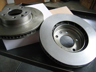

I don't believe in skimming disks.
- the pads will wear to follow the current disks' shape
- if disks judder, it is usually due to imperfections in the steel. Skimming the disks is usually a temporary fix for these imperfections
- after market disks are cheap (for most vehicles)

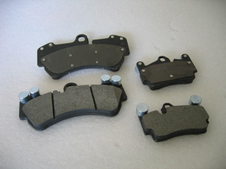

The Touareg has 350 / 330 mm dia disks which are replaced with the pads! (Comes as a kit). No new pads on old disks, no skimming!
I won't admit to the agents' price, but I will soon import a set from the USA to have ready when the current ones are kapoet.
It is worth the while though. I have never driven a car with better brakes!
