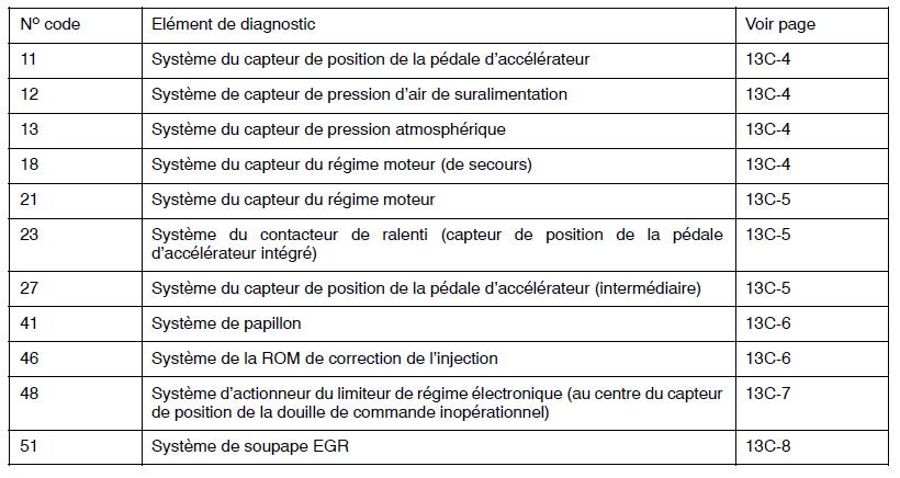

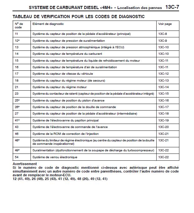

Good day everybody,
since I am a network manager at a Mitsubishi distributor in Tunisia. I can help you a little bit by the attached diagnosis codes data sheet, for 4M41 engine 2000 - 2001, extracted from the workshop manual but unfortunately they are in French seen that this last one is our second official language. So, you can translate the needed code explanation
sorry.
At your disposal for any further information.
With regards,
With regards,
