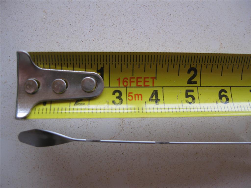

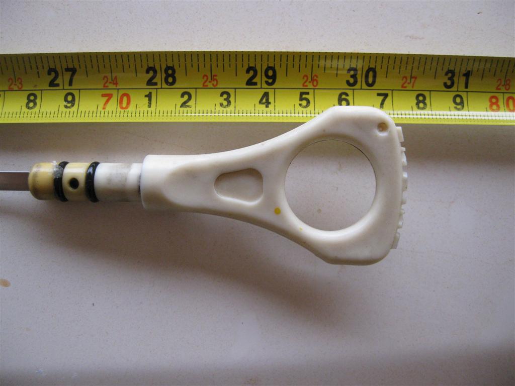

One thing bothers me: Do the marks on the dipstick give a true representation of the real oil level? In other words, if the length of the dipstick is correct. It might show the oil level is correct when in fact there is not enough or too much oil.

I always believe a 400ml overfill can't hurt too much as it splashes around off road anyway - I'm sure the manufacturers build in an idiot safeguard.
If you like I can measure my dipstick for you for comparison? Yours is a non commonrail gen3 right?

I don't know, just want to make sure our dipsticks are the same.
macjohnw wrote:
EDIT: Yes, please measure your dipstick (if I said that anywhere else, it would just sound wrong :twisted: )
See below.

Dipsticks look the same size and type as far as I can see. Just thought of something else: the dipstick sheath determines how deep the stick will go into the sump.
I will drain the oil at the next service, exactly measure the amount of oil needed and see where the mark on the dipstick is.

4ePikanini wrote:jip. looks the same - besides that yours is cleaner!
