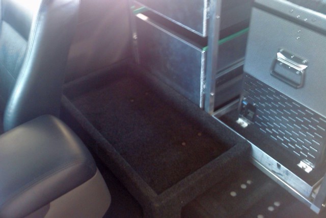

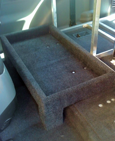

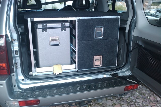

Here are some pics of how I fit everything into the SWB
- Rear seats removed.
- Packing system for fridge and drawers at the back.
- Tray for 4 x 20L steel jerry cans between the packing system and my front seat.
