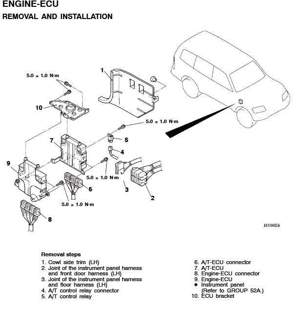

Gen3 3.2 Di-D Pajero ECU removal - DIY
Mon Dec 05, 2011 3:06 pm
