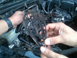

The gasket (also attached) have been obviously compromised and released gas (not yet oil) in the radiator.

Blown Gasket Image 2002 3.5 GDI Pajero

First yesterday morning was a blackout in Maputo. Then engineers had to repeat the heads skimming before gaskets installation to satisfy Jorge, the Mitsubishi expert.

Skimmed the heads and changed the gaskets, replaced the water pump, flushed the radiator.
On the way home the engine overheated again!!... :(
Has anyone have any idea on what it can be??
Please comment. It feels very frustrating...
