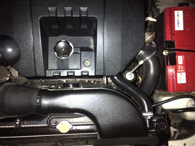

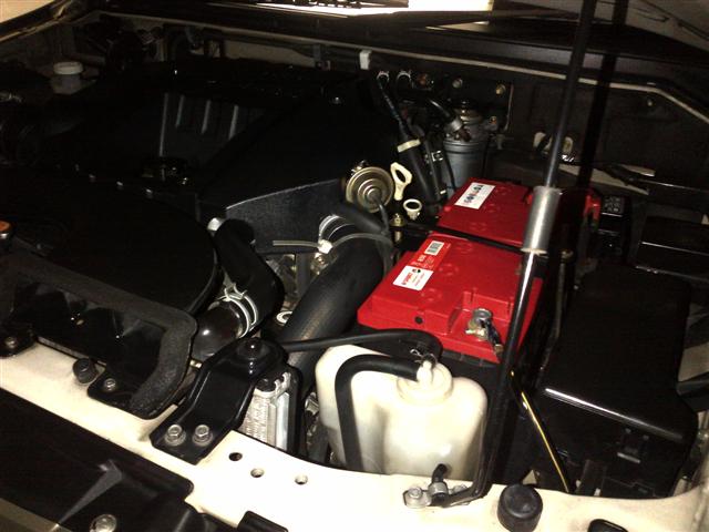

I serviced my Pajero over the weekend, and came up with an excellent cleaning agent for cleaning the engine bay and engine out.
I mixed Clean Green with water and oven cleaner, and poured the mix into a spray bottle.
Once I had removed all covers etc., I sprayed the engine and engine bay out, wiped it all down, and then sprayed with the hose (thoroughly)
The results were incredible...
