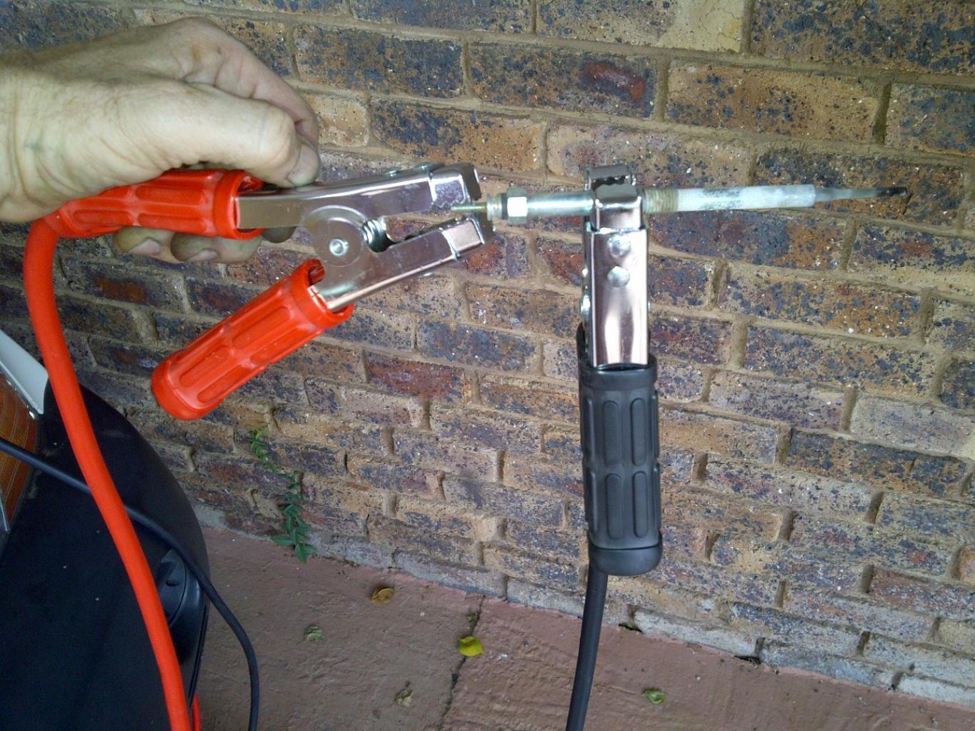

You can check the glow plugs as shown in the picture.
*Simply unscrew them one by one
*Attach red jumper cable to back of glow plug and battery
*Attach black jumper to side of glow plug and battery
*If functioning correctly, the point will glow red hot in a few seconds.
NOTE:
*Once the tip glows red, switch off immediately - do not let it glow for longer than that as it will damage the plug.
*If glowing red hot or heating anywhere else except the tip, then the plug is dysfunctional and needs replacement. Or does not warm up at all.
NOTE:
Thanks macjohnw.... I will try this.
I just need to find out where and how to unscrew the plugs.

look into the engine bay. On the right of the head between the tappet cover and the intake manifold you will see the glowplugs.Nismo wrote:Thanks macjohnw.... I will try this.
unscrew the 12v rail with 8mm socket, remove the 12v rail and then unscrew injectors with 12mm socket.
When putting back, hand tighten + 1/8th turn.
