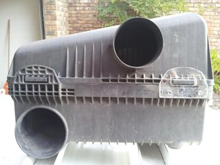

So I attacked this problem today. When I was in Mana last year I saw that my one clip was broken, but there didn't seem to be any bypass into the clean air plenum of the filter.
Then when my paj went to Mitspro for a service they made a repair (by putting a screw in). But the filter box is made of a mix of plastic and paper (I kid you not - look in the workshop manual) so of course the screw quickly pulled out.
I knew I had to try something more rugged - so this is what I did:
1. Removed the filter box.
2. Cut off the broken bracket.
3. Made a new bracket (2 pieces of 3mm perspex glued together to make a 6mm thick piece = same dims as original).
4. Glued it to the filter housing using Bostick Btitzstick for Hard Plastic.
5. Drilled and tapped two holes for 4mm dia cheese head set screws.
6. Reassembled with set screws and washers.
The filter just fits with the protruding set screw heads so watch out for set screws with large heads.

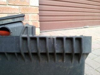

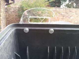

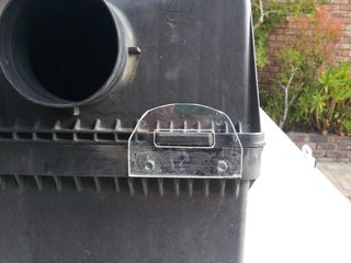

This is how each bracket should look

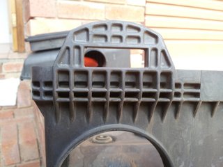

This is how each bracket should NOT look (sorry for poor focus)

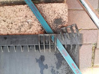

Leaving a nice flat surface to which to fix the new bracket
Bracket detail from outside air filter box
Bracket detail from inside air filter box

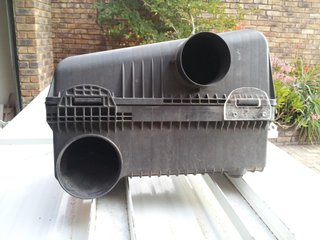

Air filter closed - NO filter element in place - NB you need clearance 12,3mm (check vs good one) above the level of the top of the filter box
Air filter closed - filter element in place
I will report back on how this does in the rough of Mozambique next month.
