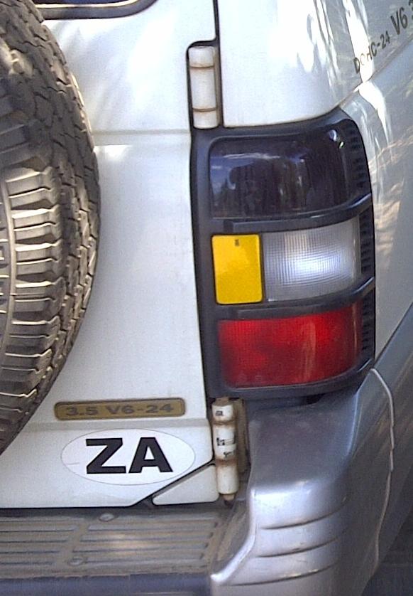

Hi all,
I noticed the bottom hinge on my rear door has a lot of movement so by comparing it to the top hinge I noticed that I can push a screwdriver about 2cm into the bottom hole of the bottom hinge, while the top hinge the pin/bolt at the bottom is flush.
So I gather part of the pin/bolt fell out.
Is it possible to remove the centre pin/bolt holding the hinge together without removing the hinge (or worse - without removing the entire back door).
Pierre

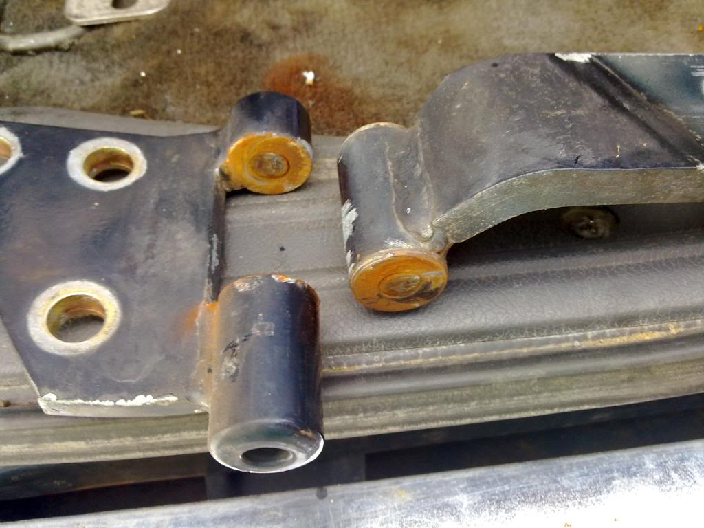

Hi Freshman,
I had the same problem..
My bottom hinge pin broke in 2 pieces..top part gets rusted shut..
The bottom part of the pin falls out as soon as it breaks off..leaving a hole for the screwdriver to fit in.
I supported the rear door by opening the door all the way then attach a long adjustable strap to the door close to the door handle (going right around the door)..but first wrap the door with a towel or thick cloth where the strap will take load.
Then attach the strap to a roof beam or something high that can take the full load of the door. (remove spare wheel..the wheel bracket will also double as a fixing point for a rope/strap to balance and take load.
Tighten the strap so that the door starts to lift up ..only to take weight.
You dont need to loosen the top hinge ..leave it as is ..to keep the door upright while hanging from the strap.
You will have to loosen the door panel at the bottom only ..so that you can get a ratchet in to loosen the long bracket that is attached to the door on the inside behind the panel.
I removed the rear right light fitting (corner foglights) also to work easier.
Then i removed the complete bracket from the body and door and put it in a vice to drill the stuck pin out...
I bought a 6mm bolt and locknut to fit right through the hinge from the top down..use washers at the top and bottom of the hinge ..and also apply some grease in the new hole going through the hinge.
Maybe there's another way of doing it better and easier..but i did it with what i had available...
See my pics attached...didnt take any during thefix stage..hope these help..
good luck..

Hi Freshman,
Yes i did struggle a bit to drill it out..maybe because my drillbits were a bit worn..
I first tightened the hinge in the vice and drilled a pilot hole of about 3.5mm/4.0mm ..through both pieces of the hinge..
..was a bit difficult to drill straight as the stuck pins couldnt be hammered out and they are a bit hard to drill through..
If you know someone with a decent Bench Drill with a built-in vice ...then rather let them drill it out smoothly ...that way you can use a bigger sized bolt (grease it up first) ..the holes going through al 3 parts will be 100% aligned...
Good luck.
