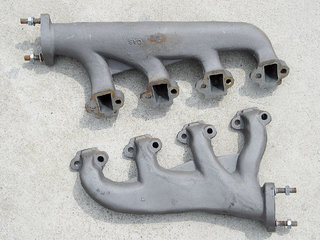

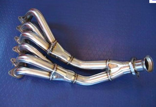

You must dfferantiate between branches
Branch
Branch
and manifolds.
manifold
manifold
Manifold are generally made of cast iron that are fitted to the engine standard from the factory and are almost always more expensive than branches.
Branches are made of mild(some times stainless) steel pipes that are bent and welded together either at the workshop of bought off the rack from a supplier like wildcat, cowley, brospeed or viper. The header pipes should all be of the same length so that the exhaust pulses do no reach the junction at the same time causing a "bottle neck" robbing performance. However due to space limitations in the engine bay this is not always possible.

Hi Nick, thanks a lot for the nice pics to show the diffrence.
