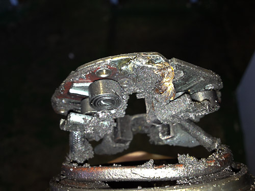

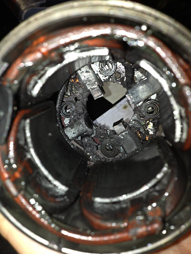

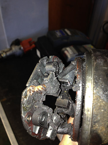

I took my paj into the auto electrician this morning.
They tested the battery - it's fine.
They pulled and opened the starter and it's not fine. See attached pics - the starter was full of gunk and what seemed to be oil. The brushes were worn.
They're going to recondition the starter. It was last reconditioned almost exactly 2 years ago.
How do you think all that gunk and oil could have got into the starter? I vaguely recollect a post on a forum saying that oil can be splashed on the starter during a service or something like that.
Any ideas?
Cheers,
D

Re: 3.2did starter issues
looks the same as what mine did. I suppose it's the brushes wearing and binding with the grease.
https://www.4x4community.co.za/forum/sh ... hp?t=11400
It was starting a bit slow so I thought I'd remove the starter and give a good clean.
I came in from the left side of the car. Both through the engine and from underneath.
I had to remove the autobox dipstick holder to gain access to the top starter bolt.
There are only two bolts holding it on - 14mm
The starter feed to the solenoid is a 12mm nut and then a spade connector on the solenoid.
I dropped it out from underneath the car.
It was dirty as hell inside.
A good clean and reassemble has drastically improved the starter spinning speed.
