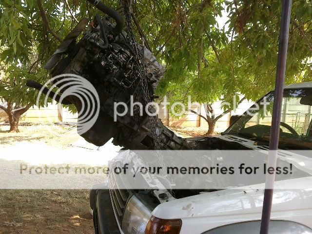

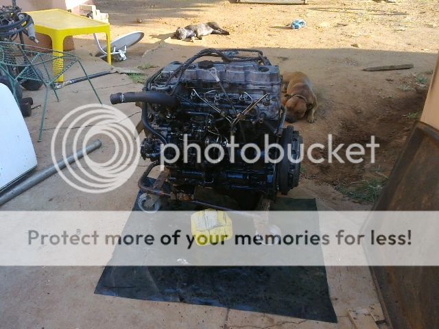

Thanks 4ePajero, but that would be a sin to do that. :shock: You did such a nice installation job there. Ye it could have worked for me if only i had the money right now. I recently bought the Pajero. I phoned a couple of scrap yards and they charge something like R35k for a engine. So i will have to carry on with the current engine. This is what i did so far.
