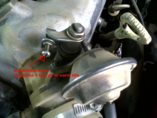

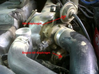

disconnect the vacuum pipe going to the idle diaphragm and plug the pipe with a screw or golf tee
The car will throw a check engine light at idle when up to temperature (don't stress about it, the light will go off when you put the pipe back on and restart the car)
Monitor the car's behaviour for the next few days. If the problem has disappeared then you need to back out the idle diaphragm adjustment screw

Also make sure that the throttle body moves easily. Manipulate the mechanism on the idle diaphragm (the picture i posted earlier)
