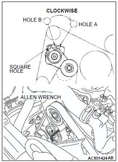

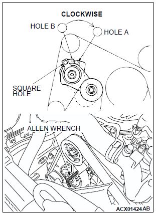

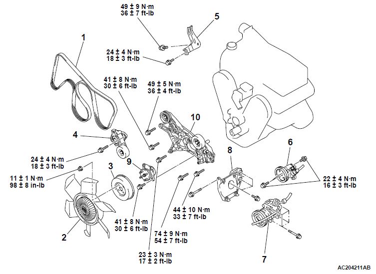

Follow CATS advise and try to isolate the sound, I had a similar problem, turned out to be my plastic idler pulley, I took the micro-V belt off and found the pulley to be very rough when turned by hand. The other smooth steel one was also on it way out so I am going to replace that as well. There is also a tensioner pulley that can be making a noise.
I don't know which Paj you have but my Gen 3 you need a 1/2" power bar or socket ratchet to release tension of the microV belt by inserting it in the square hole and turning as directed in pic (put a 6mm allen key in to hold open)
and then you can spin all the pulleys and accessories by hand to see which one is grinding/on it way out. Hope this helps.
