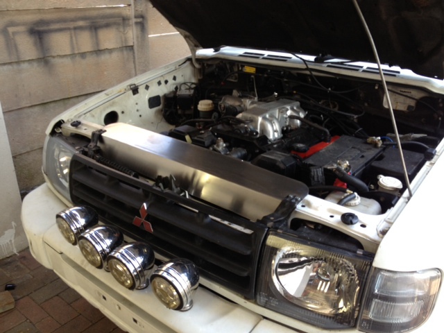

A few pics of my Lexus conversion. The vehicle is an absolute pleasure to drive, especially with the Lexus auto box. The engine itself is in my opinion light years ahead of the v6 in terms of smoothness, and it has more than enough power. Apart from a few small oil leaks it has done 2000km, in town without any issues at all.

what's that aluminium deflector in the front for?
Hi Andrew.
The cover is only cosmetic. I had to move the radiator forward to allow a little more space for proper airflow. I only seem to be able to upload 1 pic at a time.
