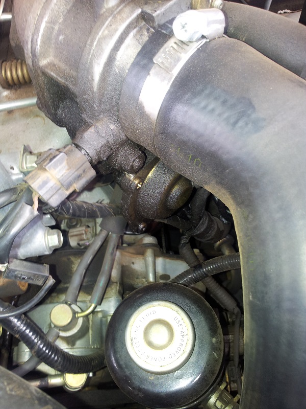

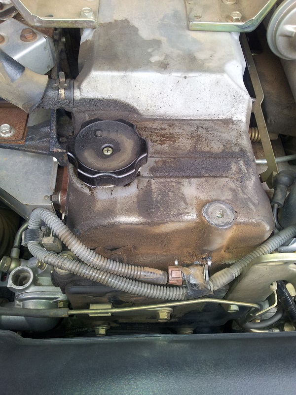

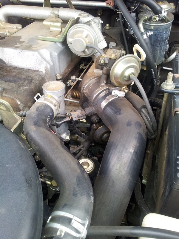

Hi Guys. I noticed a oil leak on the right hand side of the engine standing in front of it. Not sure what it could be but
would appreciate some help or info on the matter.

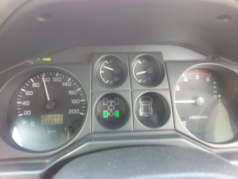

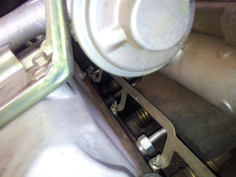

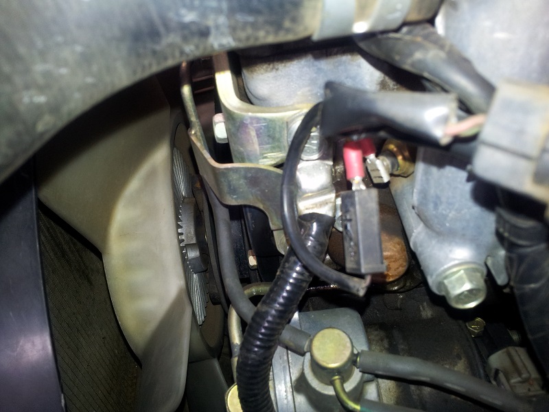

Engine has high kms on it (326 000) Any ideas would be of great help. I took some pics and attached so as to pin point the problem. There seems to be a leak at the intake if I'm not mistaken and then also on one of the injectors, which is the one I'm most worried about!...Another pic shows a plug that is not plugged in, not sure if that has to be like that or not... Also took a pic while I was driving as it looked like the temp gauge was running cold?
Any info will be greatly appreciated!
Thanks guys!!
Well Peertjies I can tell you that your temperature gauge on the photo shows absolutely the normal level for these cars.

Clean the engine and keep an eye on the leak. It could also be the tappet cover gasket, and believe it or not, it could also be the rubber seals under the bolts that hold the tappet cover down. They deteriate over time and leak from the top, which looks like the tappet cover gasket.
I will be renewing mine soon due to a similar leak. The 8 seals cost about R250 for all.

Btw: I also have the spare/extra plug.

Thanks for all the info guys! I have cleaned the mess and I'm keeping an eye on it for now. I'm leaning more towards an oil leak than an oil leak considering where the leaks are.

Hi Peertjies,
1. If you don't know the service history it is a good idea to replace the oil pressure sender. They do fail (leak) and thereafter can catastrophically fail (dump all the oil on road). You only discover that after the engine blows.
2. However, the oil pressure sender is on the opposite side of the block to where you indicate a leak. If it is an oil leak then I think your most likely candidates are the tappet cover bolt rubbers, the tappet cover gasket or the oil seals that seal the entry points of the injector pipes through the head.
Has anyone recently replaced / checked your injectors or reset your valve clearances perhaps?
