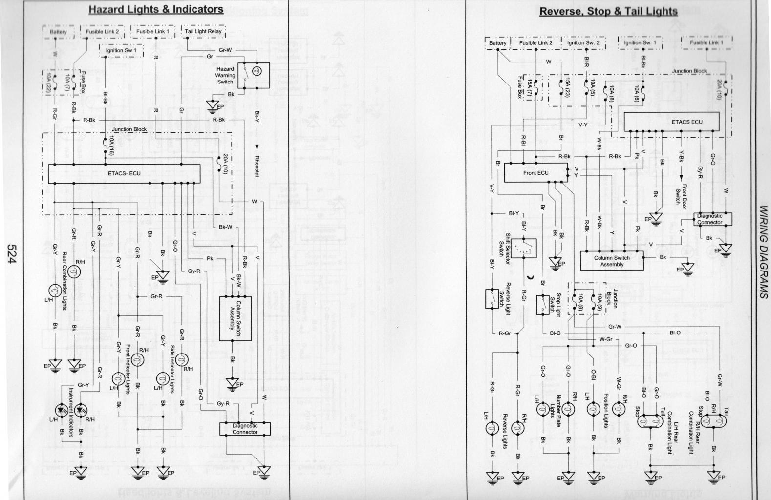

I am also looking for the electrical wiring diagram for the same model Pajero, as I am experiencing some problems on the tail lights/brake lights? Would highly appreciate any assistance please?

Stevevsr
Re: Fitting Navigation Display
Hi Johan
I have the factory manual on CD. Attached is the chassis wiring diagrams. It is in pdf format and is about 1,3Mb in size.
If you cant access it then please pm me your email details and I will send the same to you
Steve

JohanT
Hi Steve
Apologies for my lack of know-how using this forum, don't even know how to PM! :oops:
Anyway, thanks very much for the electrical fault finding procedure you posted, but is seems to be for generation 2 and not 3. I have a 3rd gen SWB. So if you can perhaps find anything on that CD of yours for Gen 3 it would be highly appreciated?! :?:

Stevevsr
Hi Johan
This wiring diagram came from my workshop manual which covers all makes of Pajero from 2000-2010.
I hope that this helps you.
The CD that I have also covers all Pajero models and a lot more intensively but I could not find the appropriate file to send.
If you need any more info please do not hesitate to contact me.
Steve
