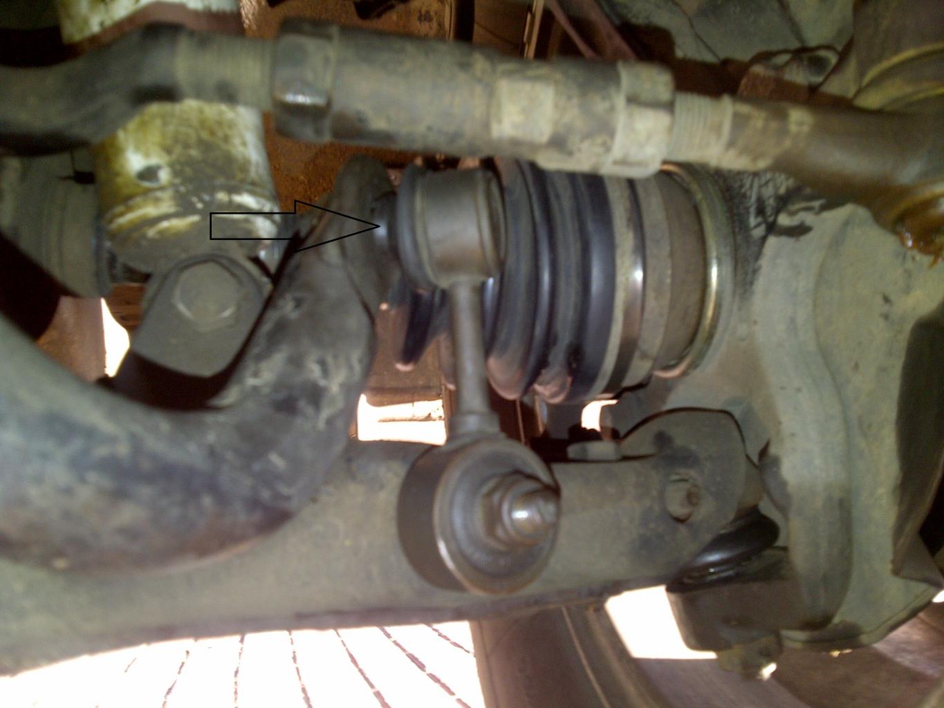

- loosen and remove first top nut on anti-roll bar ( arb )
- loosen and remove second nut on arb
- remove the washers and top rubber noting the order
- loosen bottom nut that bolts to the lower a-arm
- jack up arb with a bottle jack until the arb clears the shaft
- swivel the shaft out and replace the bottom rubber - I actually removed the whole thing
- swivel back the shaft and slowly release the arb back onto the threaded area
- put other stuff back in order - noting to compress the rubbers for about 5 turns only ( if you keep turning the first nut you will over compress the rubbers and make them fail early ) and then doing the up the second nut tightly.
- clean up

The before
The swap
The After
