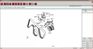

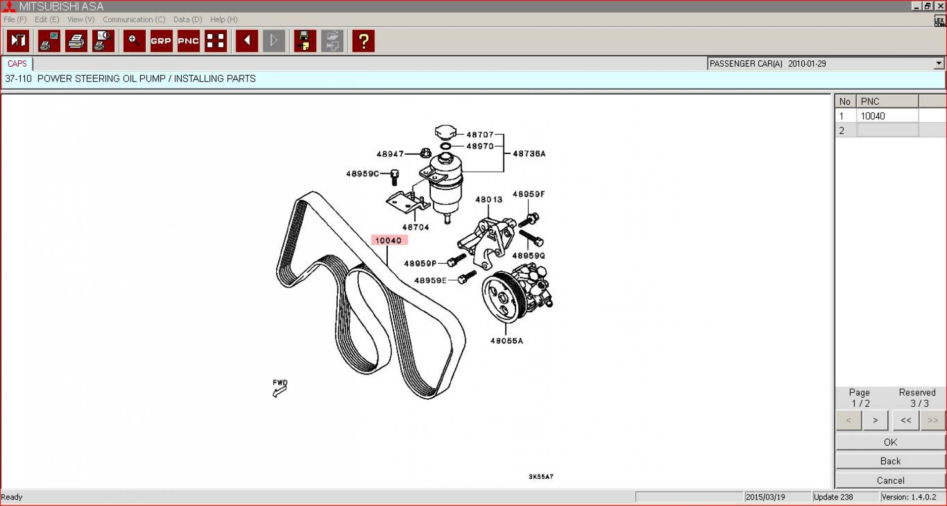

4ePikanini wrote:This one? : Part number MN155725
Thanks Marius, that looks exactly right going by the routing. Unfortunately I cannot go by a Part No here and would need the length.. any idea? Have to buy non OEM.
Thanks for your interest though, appreciated
Re: Drive belt on 6G72 motor
I believe it is ......
Serpentine Belt, Heavy Duty, Outside Length 95.74 In, Top Width 0.96 In, Industry Number 7PK2415
I think you cracked it Marius. Thanks again, great to have this level of expertise available. All I need do now is find one!
