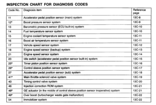

Visited Ithala game reserve on the weekend. My Pajero’s engine light came on when going slow downhill on 4h not low range. I did think its something to do with the brakes. All I had to do is switch off and on and the light was off.
Back home and I did the diy test that gave me code 41 on the engine light. Is this for main throttle solenoid valve? Is this something to worry about?
I also had the ABS light flashing 21 – Right front speed senor.

Error code 41 as you state refers to the main throttle butterfly. This butterfly has 2 actuators on it, above & below.
4m41 error codes
4m41 error codes
One is used to close the throttle completely under shut-down to reduce shudder and the other to partially close the throttle to assist the EGR in operation under part throttle conditions when the engine is warm and for a quieter idle.
Possible causes:
1. Perished vacuum hoses
2. Sticky solenoid valves
3. Mis/mal-adjusted set screws on the butterfly valve actuator arms
4. Gummed up valve (EGR & PCV gas deposits combining)
See 4epikaninis post on the correct operation of the valve under shut-down here:
https://www.pajeroclub.co.za/forum/viewtopic.php?t=4274
