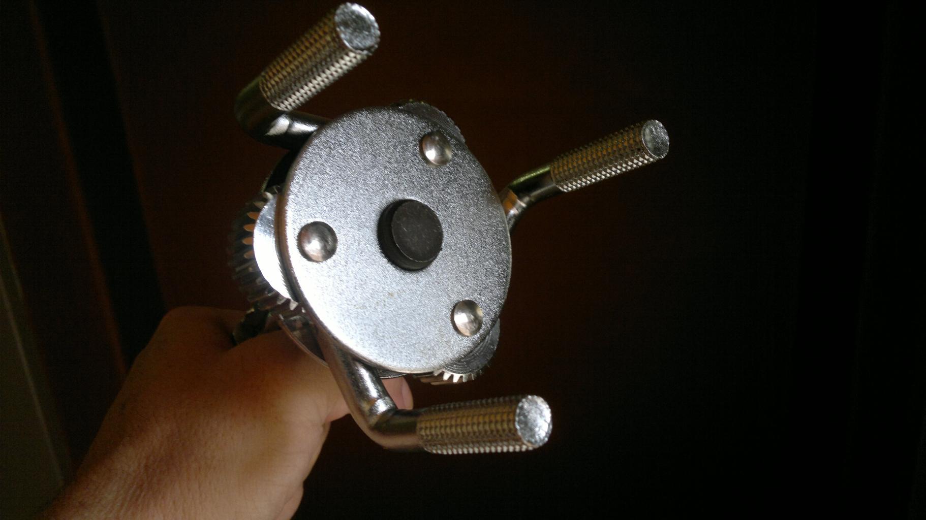

And something like this can undo the the filter quick-quick

Easy as pie, I just bought the nice tool showed by RoelfieRoux to undo the oil filter.
