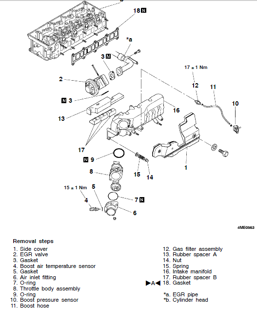

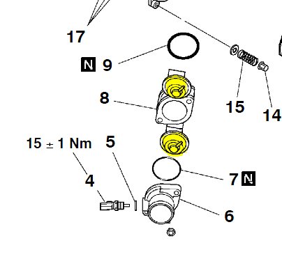

The engine dying while idling could be the vacuum operated butterfly valve in you intake manifold that is poorly adjusted. There is a set screw to adjust how much it closes the valve when the engine is at operating temperature. It's purpose to close the valve partially to assist the EGR in operation and reduce engine vibration at idle.
The Top vacuum actuator on this butterfly valve is for EGR and idle(closes about 85%), and the bottom actuator is to close the valve 100% to prevent prolonged engine shudder at shutdown.
See picture below:
