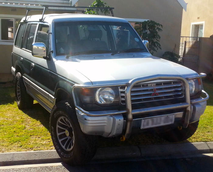

I need help and advice regarding my 1998 GLX.
Mine has 250k on the clock and has blown a ring (that's what it seems like)
It is standing in a garage at the moment, as I've not had a clear answer or solid solution, so I'm posting up here to get the best advice from the community.
In order to get it back on the road, I've thought of a few options, but I've narrowed it down to 2:
a) fit another Mitsu diesel motor
b) take a chance and open up this motor, and have it reconditioned
Here's the thing, my Paj is 1998 (originally from Zim apparently)
It's a GLX, LWB with a 2.5 naturally aspirated diesel 4D56 motor. (Quite unusual?) (I have attached a photo for reference)
Your advice here please:
a) I have the opportunity right now to fit a 4M40 2.8 naturally aspirated motor - Will this motor fit into my Paj?
What, if any modifications/adapters etc will I need?
Has anyone in the community got experience with this transplant, and could you share some advice please?
b) Alternatively, who can I talk to in the Northern Suburbs of Cape Town about a recon/looking at this motor?
Please recommend someone who you guys know to have experience with this type of motor/Pajeros in general.
(This is my second choice, as the 2.5 n/a motor is quite underpowered)
I'm really keen on this 4m40 motor, just want to be sure it'll fit with minimal missions, and that it's a good choice.
I really really appreciate any advice, thanks in advance guys!
