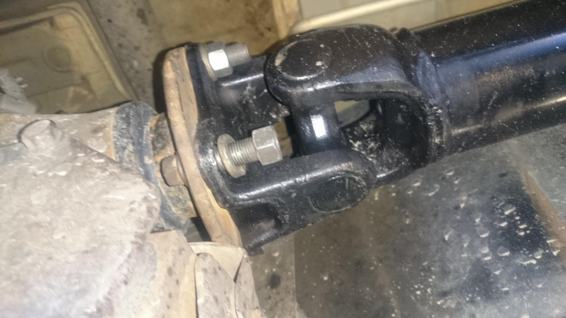

Balancing prop and replacing universal joints didn't really do the trick on the vibration, although it is a little better (UV's were a bit worn, so that had to happen anyway).

So, the balance of the prop did do the trick, problem was workmanship, see the photo attached. I was horrified when I saw this. Funny thing was car went in for a service and they didn't even notice

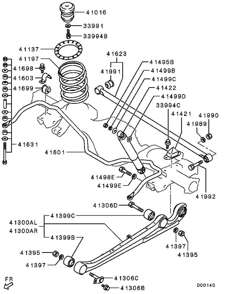

Found out the 'thunk' is the diff bushes (am I correct? diff bushes right? And what is the arm called? Control arm?) worn, parts 41399C and B in the image.
Any idea where in Cape Town/Bellville area I can have them replaced at decent price? Mitsubishi charges R500 per bush, then I still need to find a place to replace and and and.
A&M Power Steering did the work. Some parts were only available from the agents. Total cost were between R5000-R6000 but it was done in 2011 so I suppose it will be more expensive today.

Just to close things off, shudder was due to prop balance. All better now.
Thunk was sorted out by lubricating bushes. Also saw a bit of rust on the base on which the coils rest at the rear. Some lube here and voila, no more irritating thunk.
