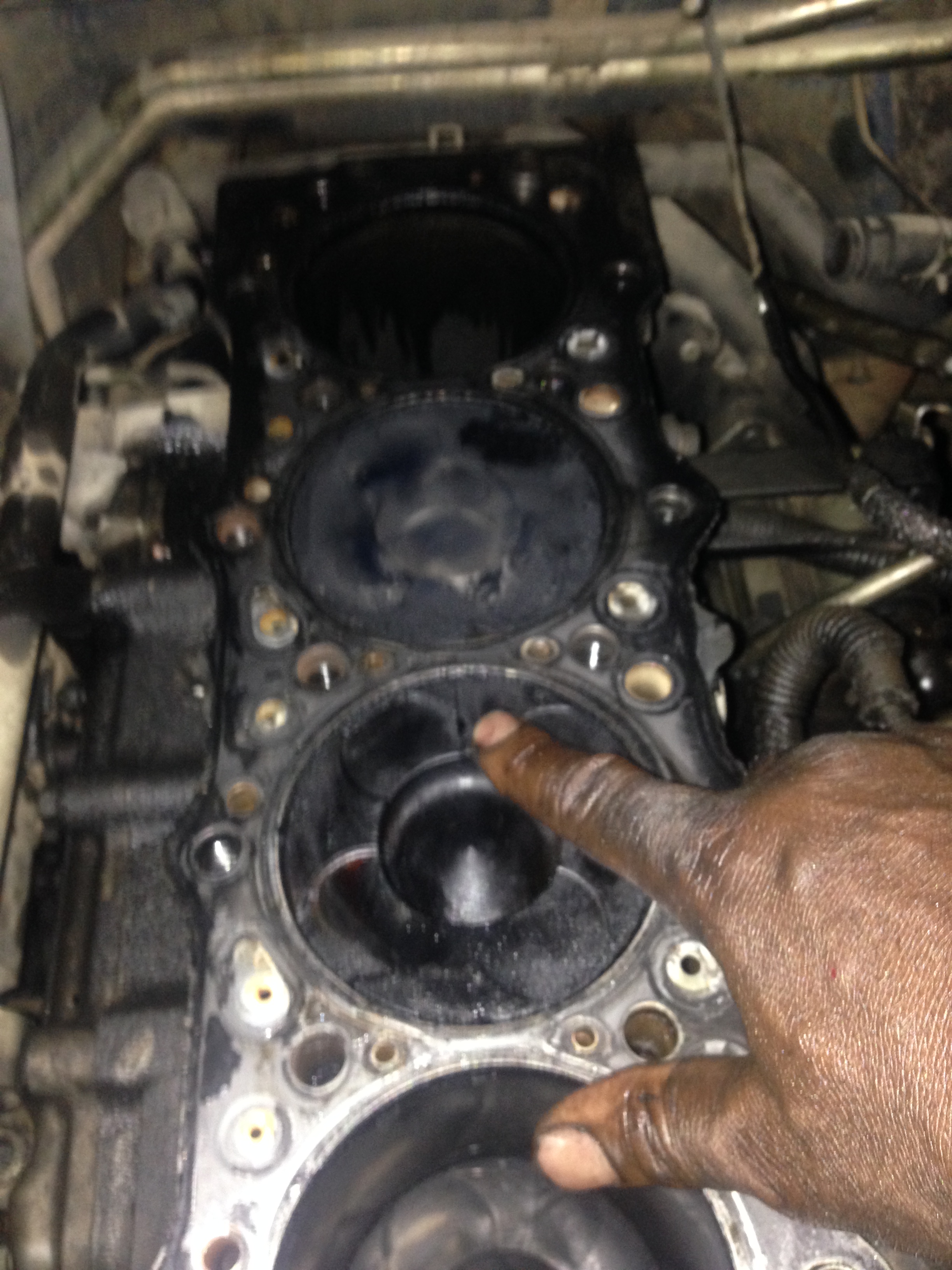

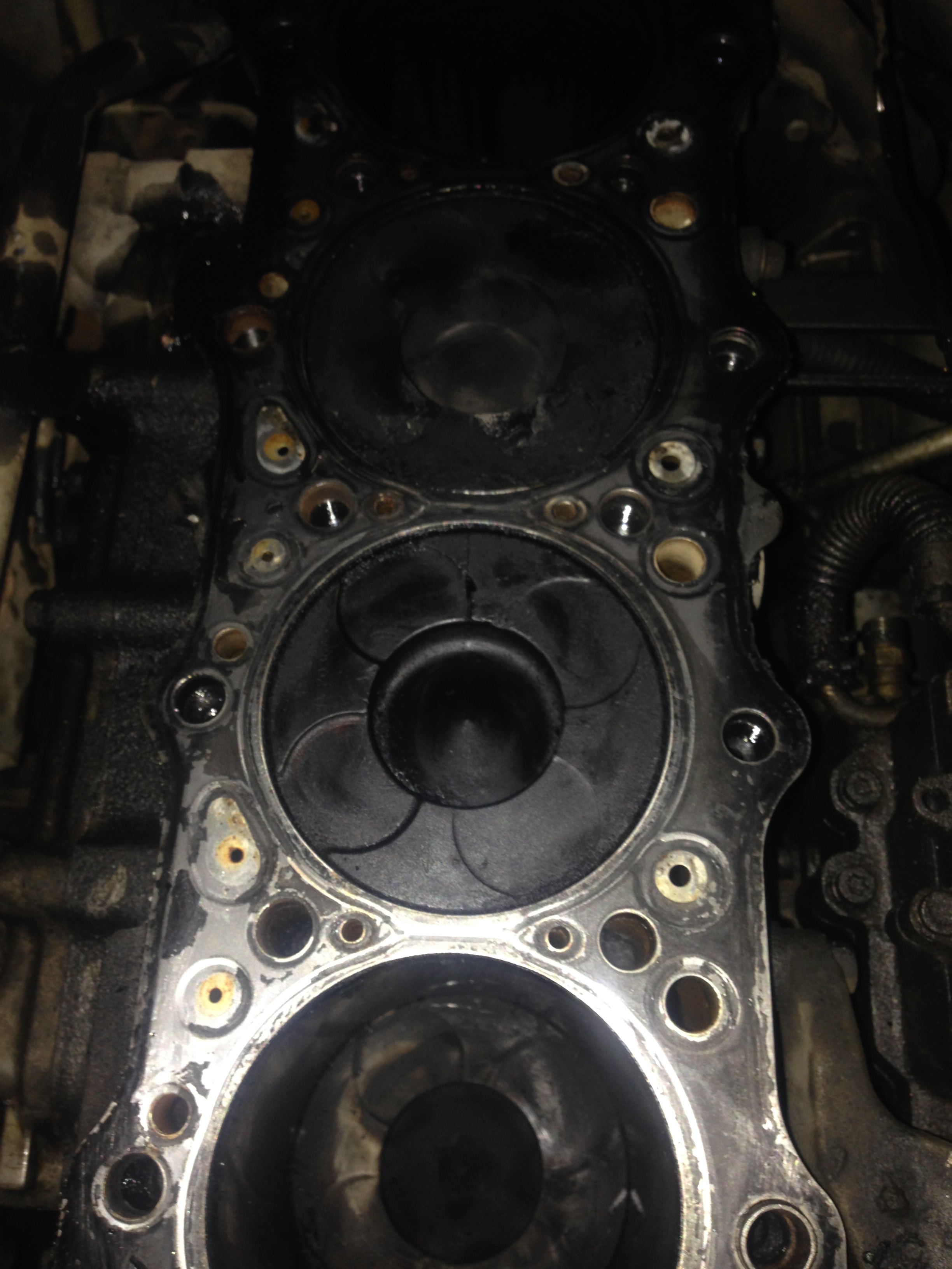

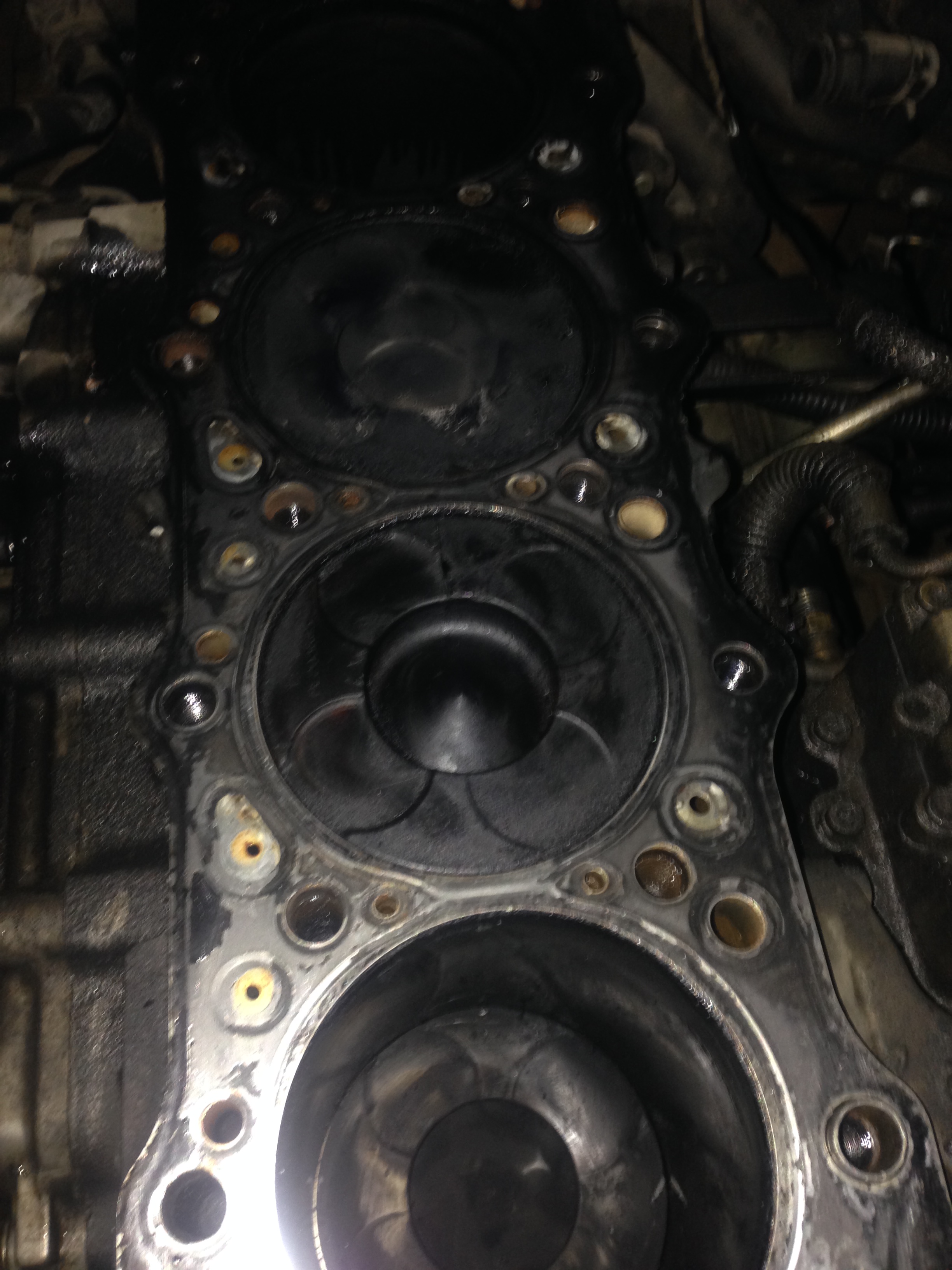

I was driving my paj yesterday when i had sudden loss of power when i wanted to accelerate. Here is what happened point by point :
- driving at about 120km/hr and decided to overtake some car ahead, so i dropped the foot to get acceleration.
- Paj picks up speed for a short while, then i here a sound like a "misfire pop" and then the acceleration goes flat.
- pushed down on the pedal, i could still get a bit of pick but nothing near to normal performance
- Drove another +/- half a KM and stopped cause i realized something was definitely wrong. Just by listening to the motor at idle, it sounded like only 3 cylinders were firing with the engine shaking a lot.
- popped the hood while the engine was still running, nothing seemed to be a miss so i decided to "limp" home (300KM away)
- I drove a short distance and the engine warning light came on.
- Stopped, popped hood again, there was nothing obvious except there appeared to be oil coming out from the oil cap. I thought maybe the cap was not firmly closed so i tightened it (mentally cause it did not move), wiped of the spilled oil , closed the hood and tried to start
- she cranked for a while and after a bit of coaxing she started. checked behind and i realized she was belching smoke
- Drove for a while, Engine light came on, I continued and then the oil level light also came on.
- When i popped the hood again, i saw there was a lot of oil actually escaping from the oil cap which suggested to me that some breather somewhere might be blocked and there was pressure build up in the crank case. (Just a thought
. No technical explanation)
- Topped up the oil, coaxed her to start and drove on
I have not opened her up yet . Any suggestions where i should look first? Anybody experienced anything similar?
