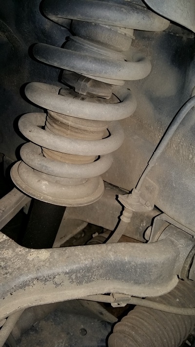

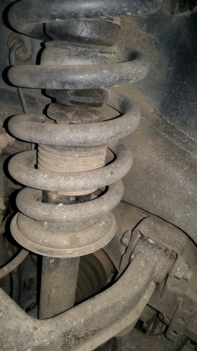

Cats I am going to show my ignorance but I have no idea what shocks I have. Since I bought the vehicle I haven't replaced the shocks. However, the right-hand side one looks much newer than the left-hand side (attached photos). Wonder why the previous owner would have replaced only one shock. The knocking sound is more profound from the left side. Wonder if I should still pursue this problem as a shock issue even though the test showed the shocks are still fine.

RoelfleRoux
Re: Knocking noise
Were those photos taken before the control arms were replaced?
When I had a knock I had new bushes pressed into the existing control (front) arms and the rear trailing arms. I also had all four shocks replaced.
It is so difficult to really find the culprit and one has to assume that if something has warn itself out, that the rest of the associated components are also on the way out.
