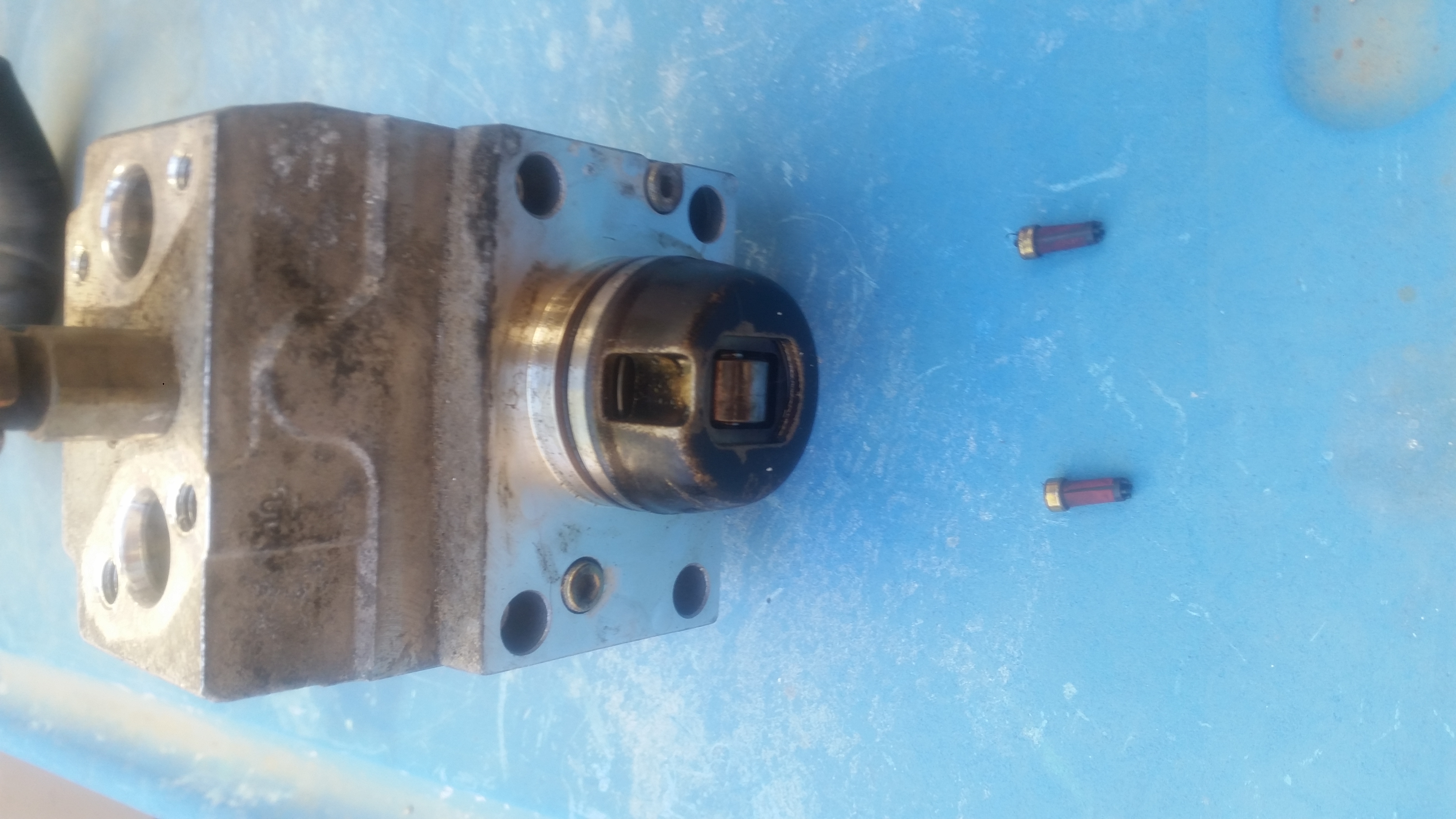

My GDI Petrol pump is giving hassles.
I have heard only of a company in Namibia that are able to recondition these petrol pumps.
I am not paying what they are asking for a new pump at Mits.
Please if anybody has any advise on it I am open for suggestions.
Thank you

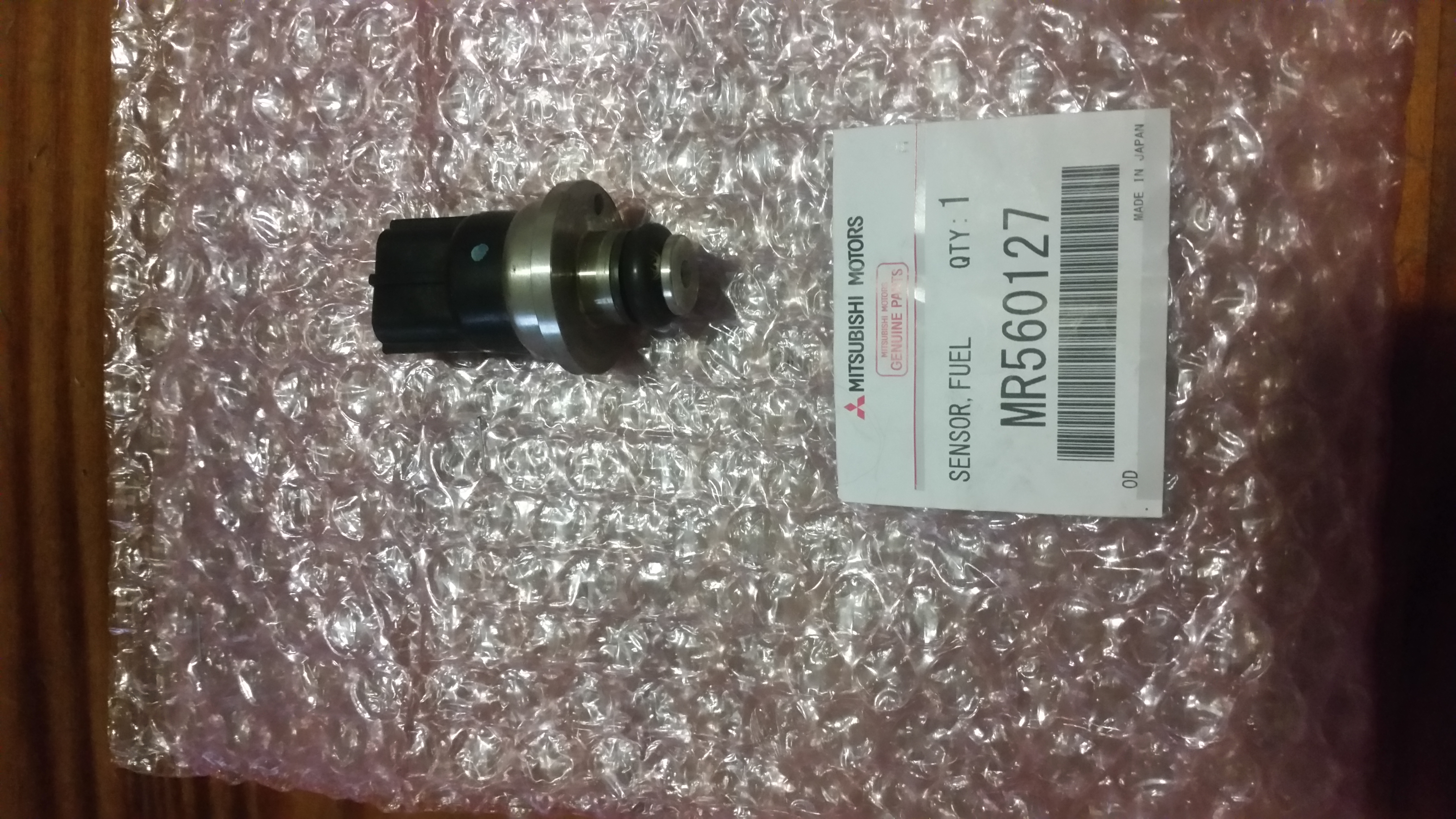

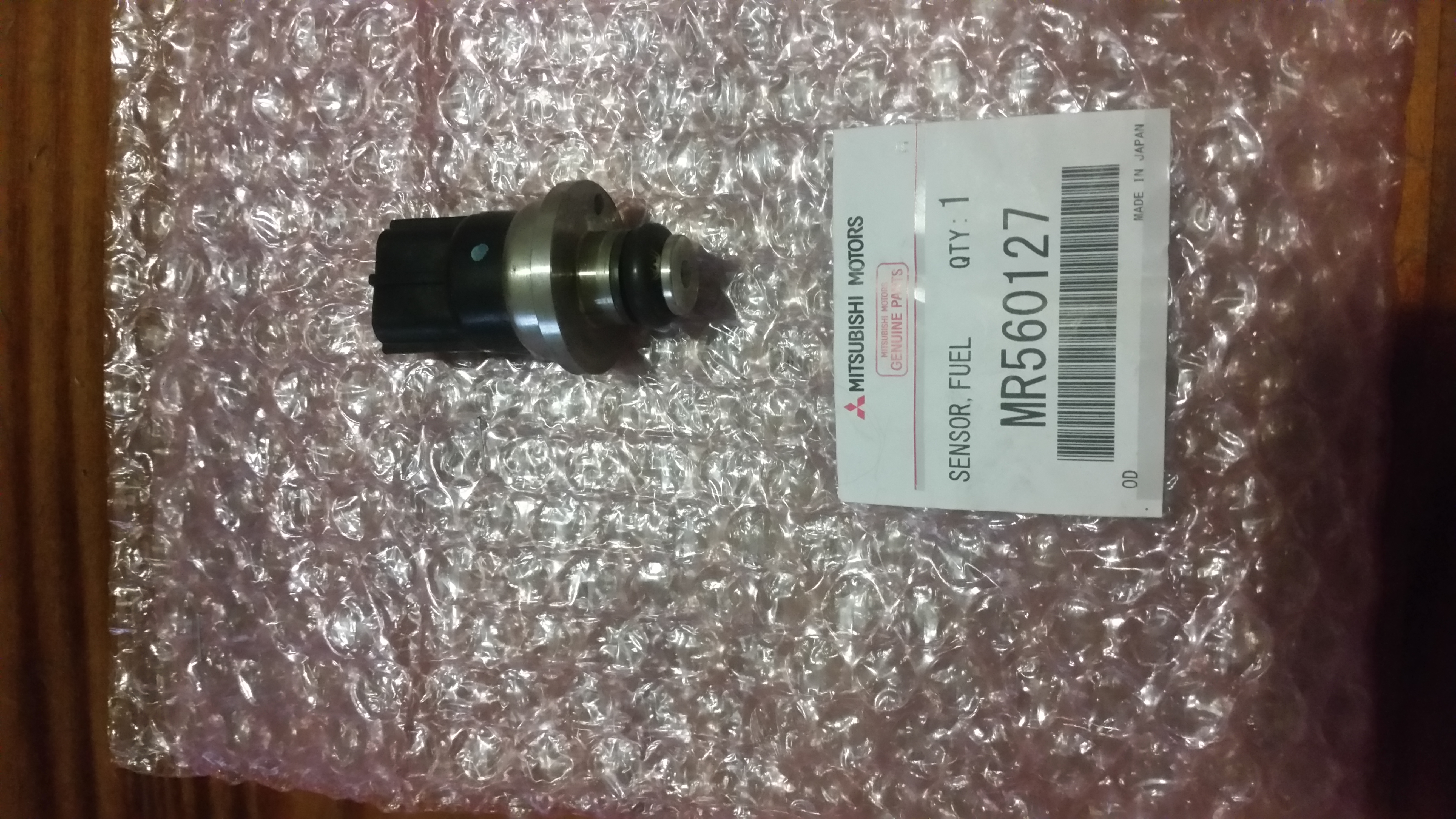

Hi you not said whats the problem model. I've got a problem with my Pajero GDI. Fault low pressure code 56 found sensor rear of engine no circuit. Car goes into limp mode new sensor on order ex Japan.
Hi feedback removed pressure pump and took out the internal filters. Fitted an inline filter replaced tested no faults as previously experienced. Early days to say it's cured but not gone into limp mode.
Sorry forgot to mention got and fitted new pressure sensor. As I said was waiting for supply from Japan. Got some new pipes small around throttle body. Agents said not available cost inc pipes postage and duty a lot less than what agent wanted for sensor. This is the old one I removed. You can't test it but not going into limp mode. If all else fails you need to replace this sensor.

Hi feedback since fitting new sensor as my previous posts no problems. Obtained from Japan via Megazip. Good luck with your project.
