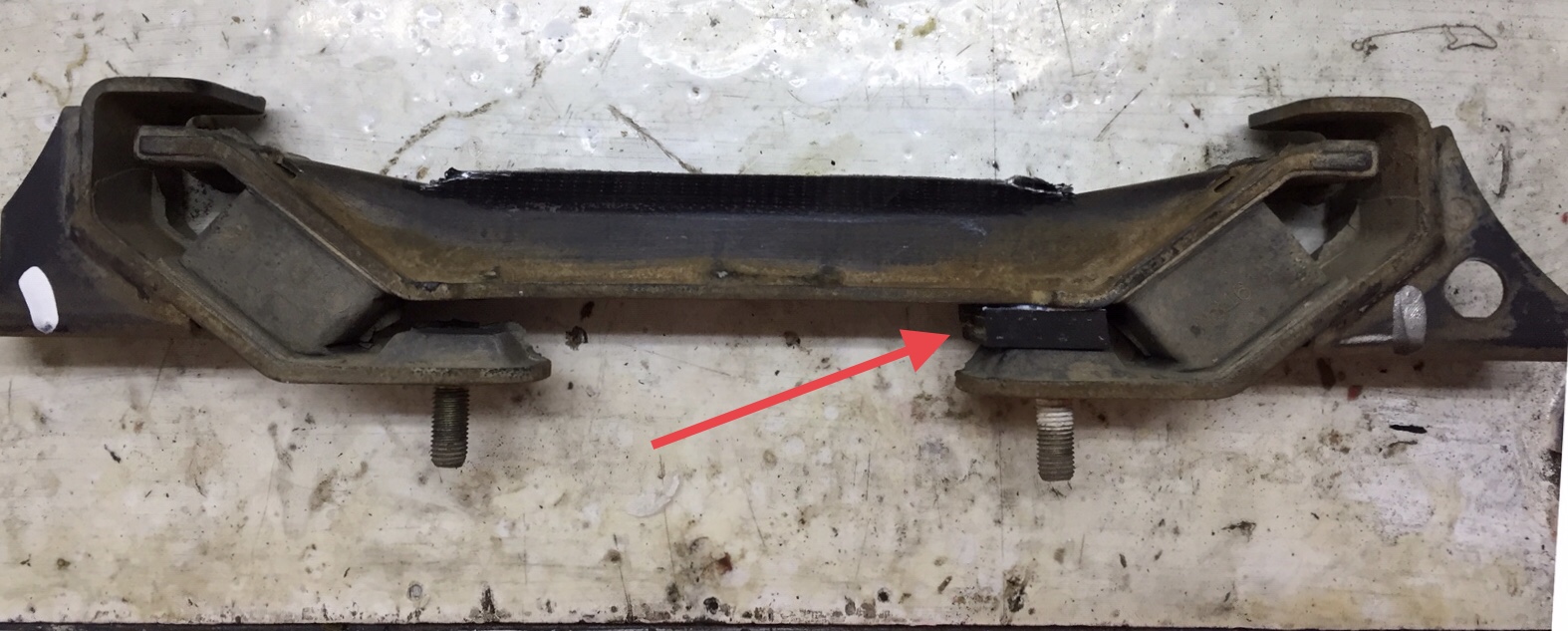

To address the difficult gearbox changes, I have made an alteration to the gearbox mounting which costs nothing and should take max 1 hour to do. I postulate that the difficulty is due to there being too much play in the mounting due to the rubber deteriorating over time.
I have inserted a square of rubber under the mounting which makes the gearbox ‘flex’ less.
See picture.
You have to support the gearbox and remove the mounting. I was under the impression that gear changes were smoother, but, I have not been able to test due to lockdown.

Hi Ernesto. In my opinion, the gear changes are are smoother and quicker. It did not solve the clunk, but, it’s worth the effort and something that you can do for free.
