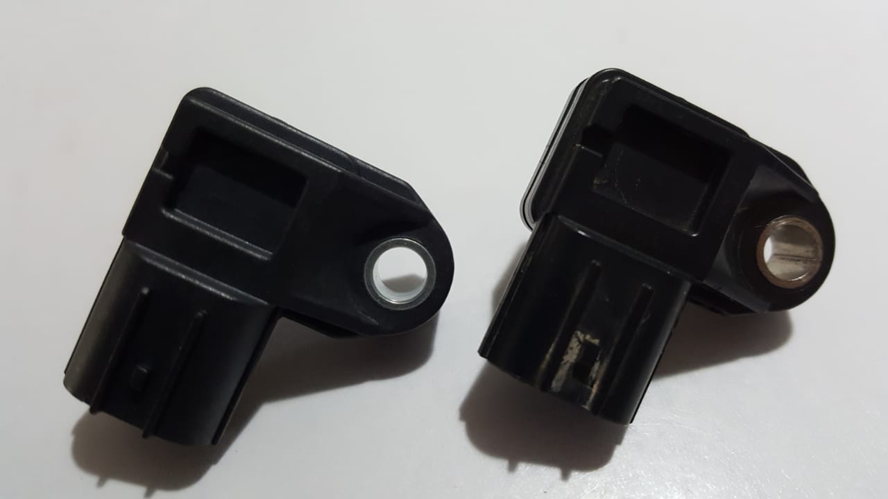

This week we cleaned the EGR and inlet manifold (including MAP sensor and plumbing) - vehicle must have been suffering from severe asthma! Enormous amounts of carbon and gunk was removed from the inlet manifold! I plugged the OBDII monitor I received from my sons as a b/day gift, to reset the error codes. Lights still come on, but we noticed that as soon as the turbo starts spooling past about 65psi(?) it flat lines - no boost. I am assuming that points to a faulty MAP sensor?
Where can one find a reliable second hand MAP sensor in the Western Cape (Swellendam). Is it worth fitting a used one? They are quite expensive new. Maybe someone out there can advise if I'm on the right track? Presently I'm driving a normally-aspirated 3.2 DiD!
Also, I aim to blank off the EGR. Good idea or not?
