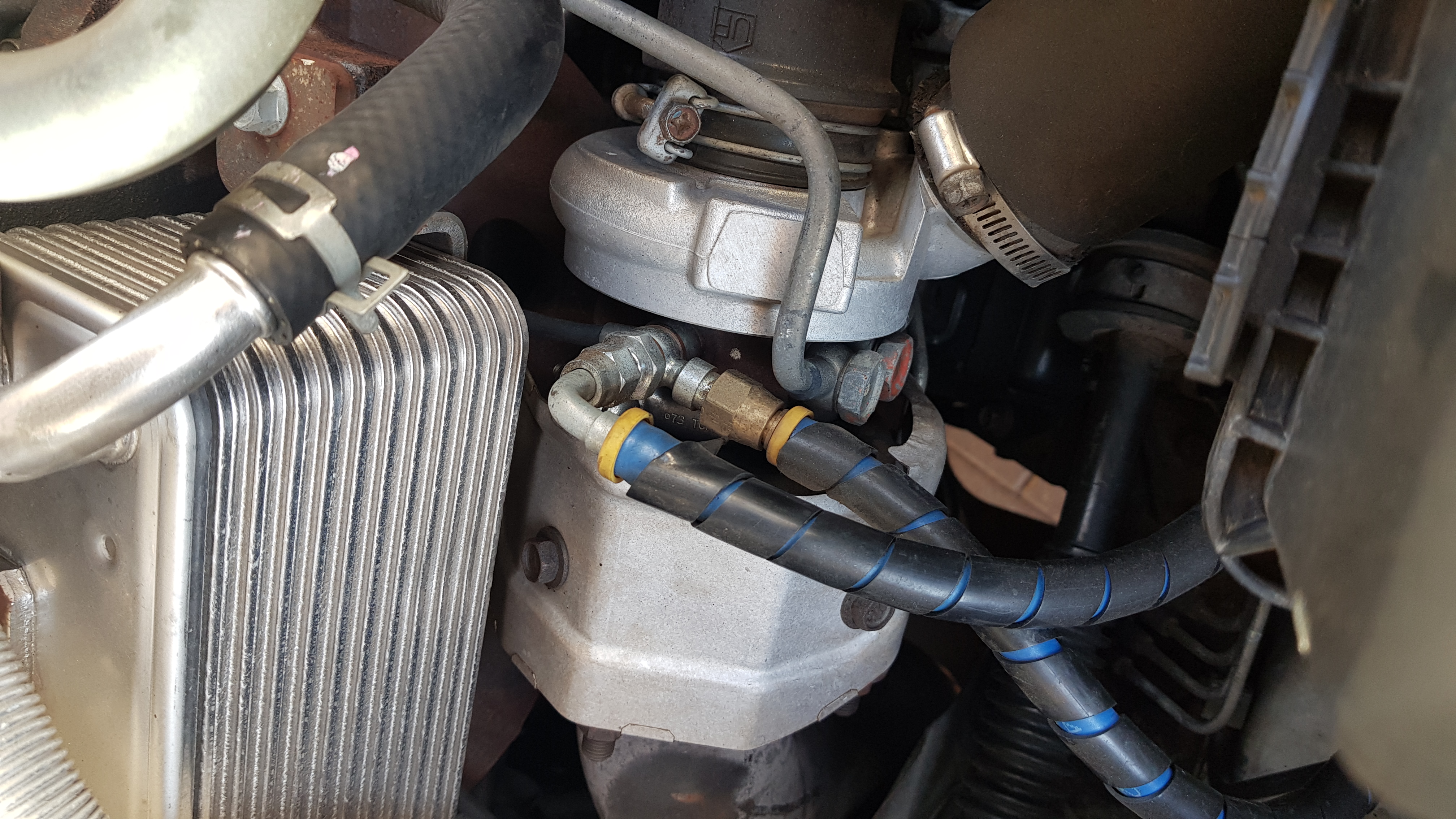

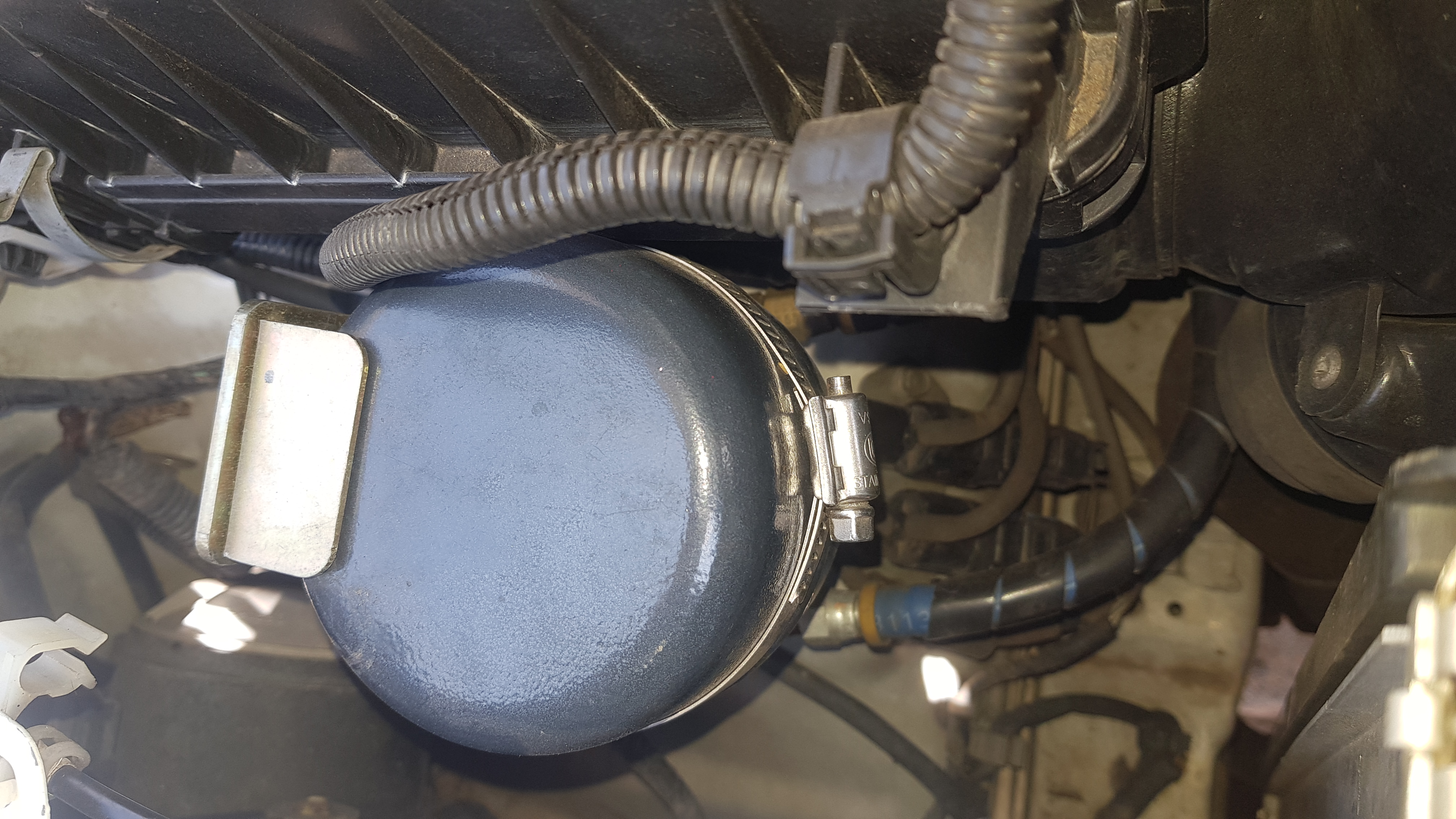

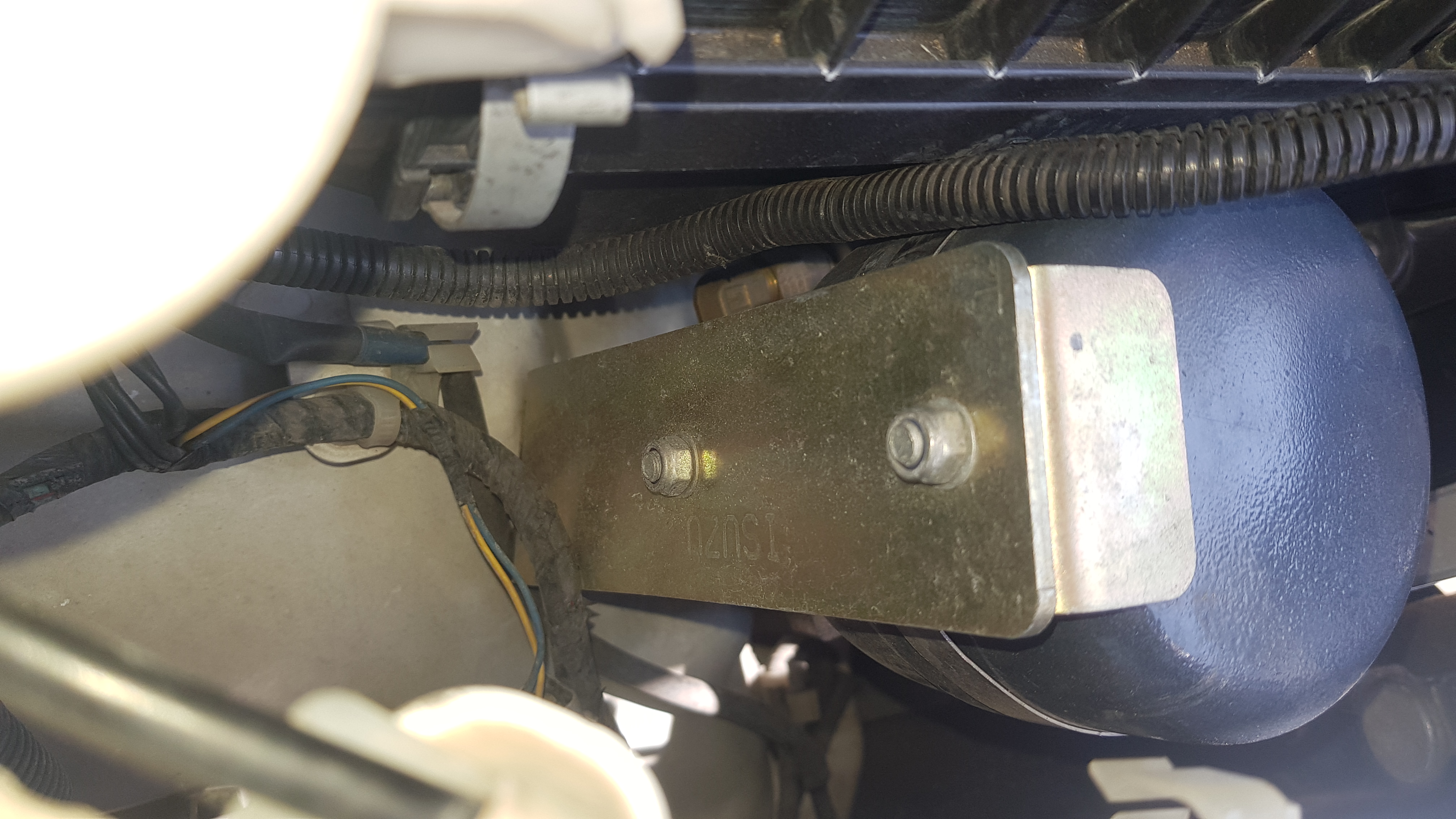

One of my mates is a bit of a diesel head and when we were inspecting the engine last weekend he noticed some strange modification to the engine bay, upon inspection we saw that the vehicle had an after market turbo installed in place of the original one. Leading from the turbo was some sort of plumbing lines connected to what looked like some reservoir near the front-right head lamp (pics below). In his point of view this was very poor practice and done with what looks like plumbing parts and an "IZUZU" bracket so he wants to take the whole thing out and restore it to its "original" design.
Just want to ask has anyone seen something like this before and what would the reason for something like this be? Also any risk of causing major issues if we took out the plumbing and restored it with an original Banjo bolt?

Looks like it would be an oil reservoir for some reason... I'm no expert but that should be plumbed into the rest of the vehicles oil supply to serve any purpose? Unless theres a pump there too somewhere. But there shouldnt be a need for an oil reservoir unless theres an oil delivery issue?
The plumbing parts look pretty budget and uh... not advisable...

Thanks Peter,
Yeah my mate was thinking sort of the same thing, he said if anything we should replace the water pump and move it forward but in terms of this current mod it doesn't make too much sense.
I'll chat to him about the potential oil delivery issue and forward him your thoughts just as something to keep in mind so we don't end stranding the car in the workshop.
Thanks for the advice and keep well
Cheers @4ePikanini , looks like you nailed it down, thanks very much!
